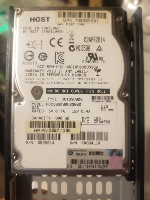

12x 900gb hitatchi HCBRE0900GBAS10K (see pic), want them in raid z3 since they're older and 2nd hand

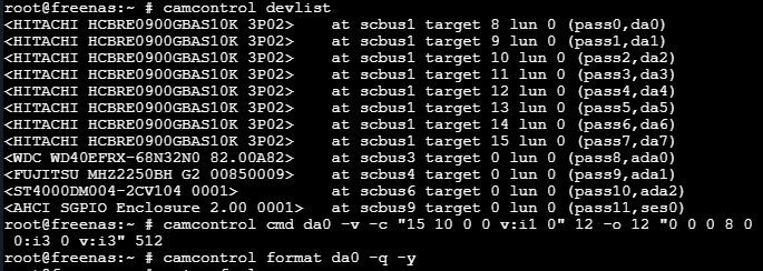

wanted to update you on what im currently trying, these drives are have their sector size to 520, so they need to be reformatted to 512
i tried following the guide here http://www.sysop.ca/?p=208 , but it didnt seem to apply the setting to the one drive i tested

This is the guide that I have referenced in my bookmarks for this topic. Used it successfully "a few years ago".
Hm, i wonder why it didnt work then. its entirely possible i didnt do the command properly, since i dont know what the params in quotes are for
after running that command i did geom disk list again
according to this the sector size did not change, where there any extra steps i missed?

OH! i went to install centos and one of the scsi drives showed up!
it looks like geom list disk just wasnt sending the updated information (maybe it was cached?)
either way looks like the first way worked, or possibly needed a reboot. ill follow those steps so i dont need to install a new os
Will report back if that solved the issue.
ayyEve
Apr 21, 2020
11
looks like that did the trick! i was able to create a pool with the drives!
Thank you so much for the help, and sorry to bother you with all this.
