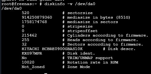

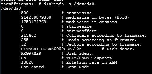

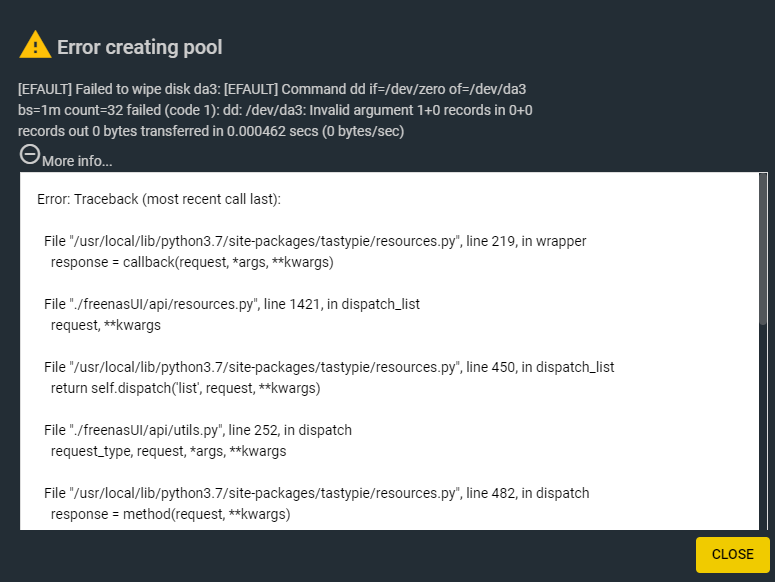

Sorry to necro an old post but I'm having the exact same error, these drives don't seem to exist even though they're listed.
I've been at this for a few hours and I don't know what to do now.
I have 12x900gb hitachi sas drives in a das connected to a p822 (running in hba mode)
I'm trying to build a raid z3 pool but the gui gives me this:
Here's the screenshots from the commands you asked for in previous posts, I do not care about any data on these drives, they are 2nd hand

Redcoat
Feb 18, 2014
2,922
Welcome to the forums.
Use the search box at the top of the page and look for P822. Many posts describing bad experiences nd background with P822. What you need is a real HBA to replace the P822.
