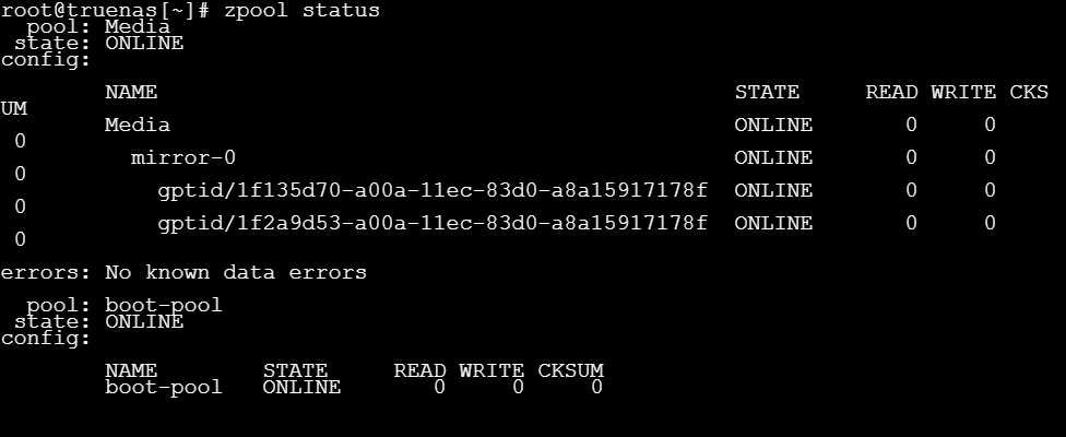

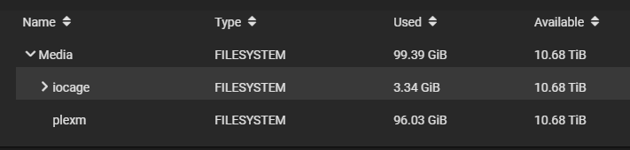

Hey folks!
I set up my first NAS yesterday and I thought I had it all configured correctly, but I'm running into a weird error. I'm not super knowledgeable on being a power user so I'm not 100% sure what steps I should take to diagnose the issue. I've checked out most of the other threads with the same issue, but haven't come up with any fixes.
Here's what I can tell you:
- I'm running the STABLE version of TrueNAS Core
- TrueNAS is installed on an SSD
- I have mirrored 12 TB drives set up in a pool with 1% of the storage used
- The SSD is not part of the zpool that I'm aware of
Here's a couple of screenshots:
What can I do to diagnose this issue further so I can solve the problem?

What issue?
You have used 96GB of 10TB (approx)
Plenty of space

The output of zpool list -v and zfs list would be helpful.
Based on what little information supplied, the "Error: No Space Left on Device" sounds like you filled up your boot-pool. This can happen when using too small of an SSD, (like less than 8GBs). Or, you tried to copy files over but mangled the destination and it came out under "/".
So, use SSH to login and try df -h to see what file system is full. If "/", see what is using the space.
