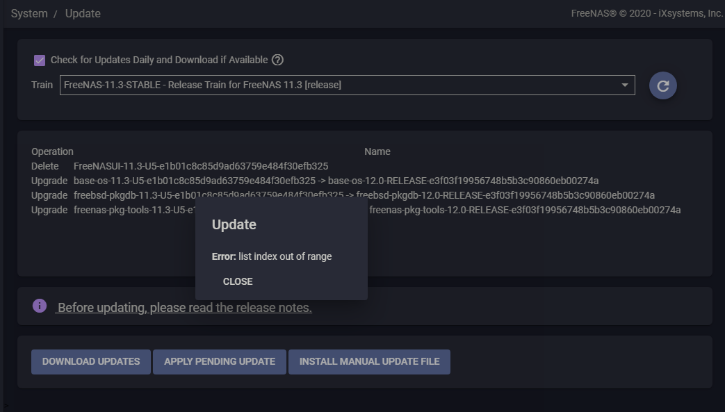

Error: List Index out of range - When updating 11.3 Stable
Gimpymoo
Sep 10, 2018
39
The updater hangs on 67% for a long time then comes up with the error above.
Current Version:
FreeNAS-11.3-U5
Suggestions welcome.

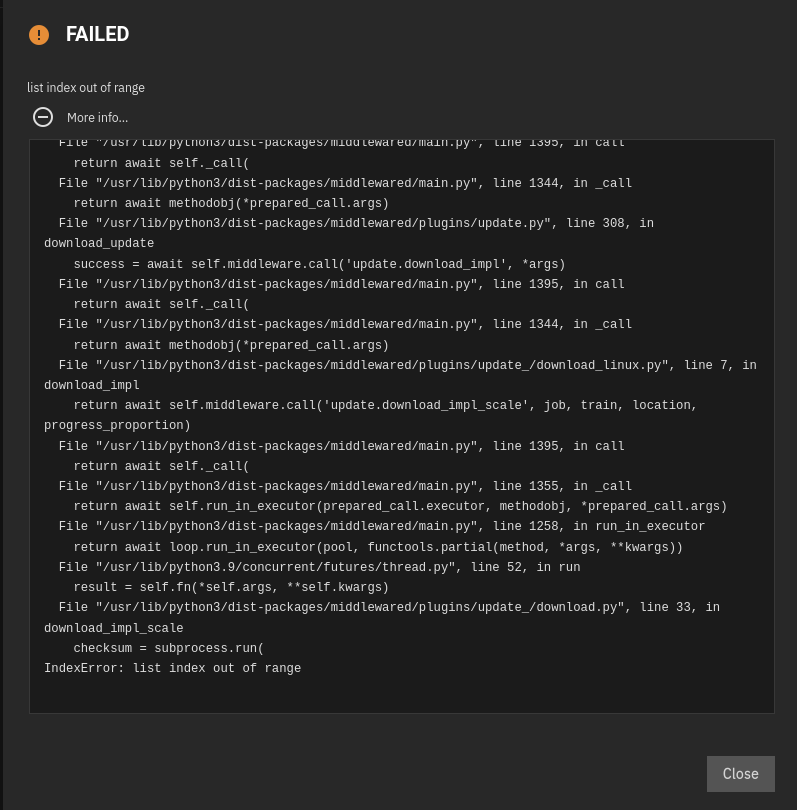

I'm getting this error on TrueNAS SCALE when attempting to upgrade TrueNAS-22.12.3.3 -> TrueNAS-22.12.4.1
So far I haven't found a workaround. I've tried rebooting but new version was not installed, and I also tried 'Install Manual Update File' however the error occurs for that aswell.
porjo
Oct 12, 2023
The fix for me was to remove /var/db/system/update/update.sqsh and try again (that file was showing as having errors in the output of 'zpool status -v')
