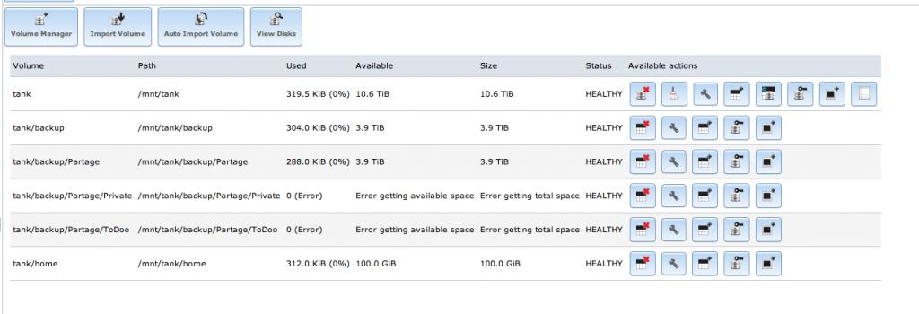

I have setup a large server with 32711MB of RAM and optimized settings (hope so) - running FreeNAS-8.3.1-RELEASE-x64 (r13452) on an Intel(R) Xeon(R) CPU E5-2609 0 @ 2.40GHz.
I will use It as a backup server mainly.
I have started backing up another FreeNAS device using the documented method of ZFS snapshots over ssh.
I have no particular error during snapshots…*but after the snapshots backup has been conducted I have the following strange behavior :
1. GUI indicates that the mounpoint where snapshots are conducted is healthy but "Error getting available space + Error getting total space"
2. If I had a look at the server using CLI, I can't find this error : the output of the zfs list and zfs status seems ok :

Since this is a server that's intended to be deployed in production in a quite critical environment, I just wanted to know if there was anything "strange" in my configuration or if this was a "bug" in the GUI ?
Thanks for your help.

I know this is an old thread, but if someone still gets this behaviour I had similar issues and was able to solve them.
The problem emerges when you have dataset inside dataset. When you initialize the replication, the "root" dataset is created as read only. So you have to manually create it to target or change it ro read write:
zfs set readonly off tank/subtank
or zfs create -o readonly=off tank/subtank
Kari
