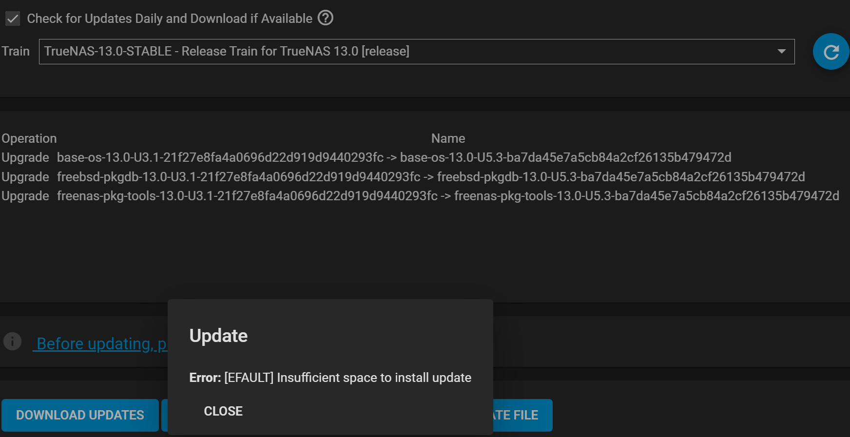

I have gotten this error when in TrueNAS 13 stable (brand new install) on a 120G SSD when I go to System > Update > Apply Pending Updates.
"Error: [EFAULT] Insuffcient space to install update".

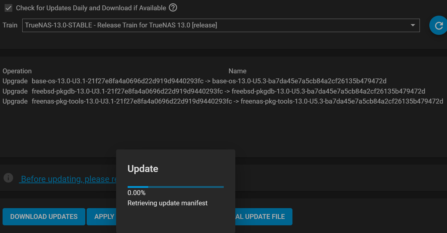

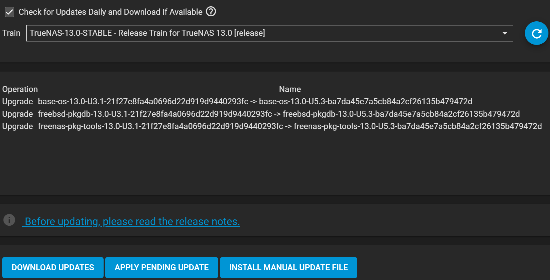

This is what I see when I attempt the updates (after a few attempts, the final one being where I took the pictures), on the second image the update percentage goes straight from 0.0% to the error as seen in the third image.
I have plenty of other things to be doing elsewhere, until this is fixed the server will remain offline.

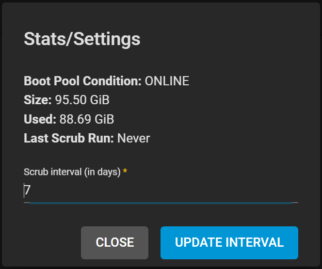

You can find this info under System / Boot / Actions button around the top right / Stats/Settings
Excellent, we are getting somewhere I also have enough space to install an update, surely.!
Enough space, maybe, it might not be enough (depending on what exactly is being reported there, what support logic is doing, etc.)... But there is no scenario where you should have 80+ GB on your boot pool, so something is very wrong there.
This is a weird one and you'll have to get over your fear of the CLI, because we need the output of zfs list -o space bootpool, where bootpool is whatever the GUI reports as the name of the boot pool (used to be freenas-boot, but not anymore on newer installs). Alternatively, zpool list will, to no surprise, list all imported pools.

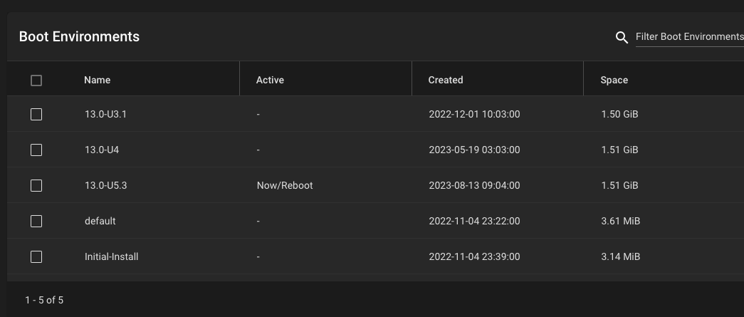

It seems to me that system -> boot would be relevant, in that it would show the boot environments and how much space they're using:
Yes, there was this weird (as a lifelong Windows user, and dabbler in Linux) partition in the Megabytes. I will update this in a while with screenshots.
There were only two items listed, One under the "active" column said Now/Reboot, the other was blank as are yours, and aligns accurately with when I installed it (3-days ago).
