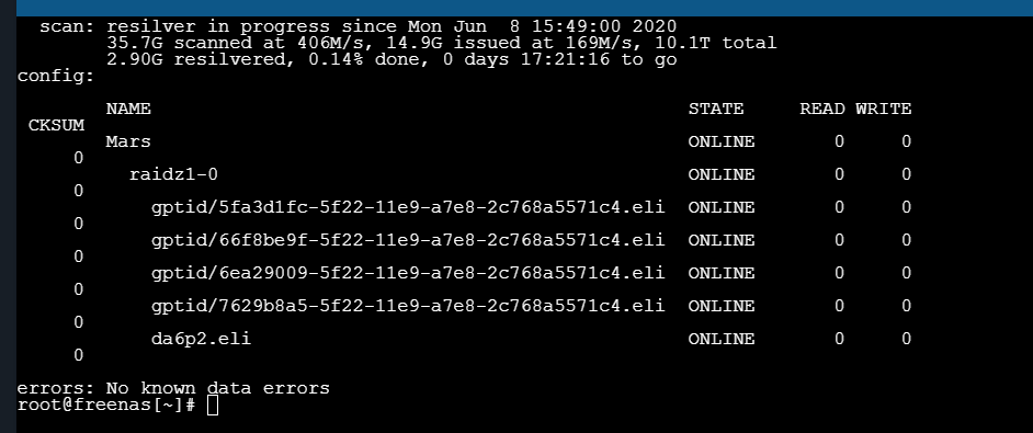

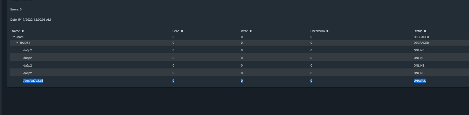

2 days ago, I disconnected another drive that is not being used, resulting on a name change for this drive and the pool getting degraded after a reboot.
As you can see, doing "Zpool status"
The last drive for some reason is attached to "da6p2.eli" instead of the gptid as the other ones.
Could you provide me some guidance on how to fix this?

The issue with the name is not just visual or OCD, if I remove or add a drive on the server, that is not even part of this pool, sometimes the name can change of this drive (currently da6p2, but was da7p2 before).
The drive that I removed, since it's not being used right now, had an inferior number name to this one, so when I rebooted the server it started with the pool degraded as the drive was missing because had changed it's name.
So my logic is if I online the drive based on the Glabel instead of the name, it should prevent this from happening again.
I've had to manually mount and online this drive 3 times already this is why, every time I change something I already know.
