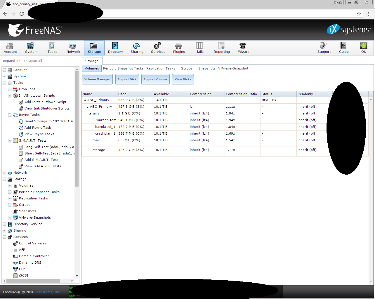

Howdy everyone,
I've setup and have running the following
2 x Proliant ML10v2 with 8GB Ram, 5 x 3TBWDRed HDD's and Using two 8GB Toshiba Pen Drives (one as the master, the other in a Raid 0 Configuration with it)
The 5 Drives are configured in a Raid5 Configuration (SATA with AHCI setup on the proliant) and its been running quite nicely, the second Proliant simply is backed up to from the first machine using RSYNC
Box's are intergrated into my aged w2k3 AD, with windows 7 machines in the network (8 of them)...

You're passing a RAID5 array to FreeNAS? That's not good... ZFS works best when you give it direct control of the drives. Are you using a RAID controller? Some RAID controllers can be configured to work as simple Host Bus Adapters (HBAs), allowing you to pass all of the drives directly to FreeNAS. You would then create a RAIDZ-1 (roughly equivalent to RAID5) or RAIDZ-2 (roughly equivalent to RAID6) array. The ZFS Primer is a good place to start learning more about ZFS.
Regarding scripts: there's a resource that includes several scripts, some of them email you status reports about your pool and the SMART status of your drives:
https://forums.freenas.org/index.ph...for-freenas-scripts-including-disk-burnin.28/
Good luck!

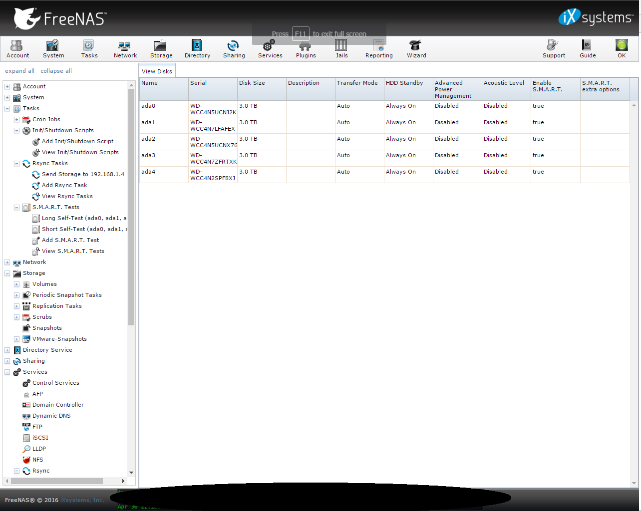

Good luck!
RAID 5 - Not that I am aware of, the box has a raid controller yes, but it only supports RAID0, and that is it, So rather than having it do Raid 0, then putting a raid on top of it, I've choosen to have them all reporting as individual drives, and then freenas has made them into a raid ..
Will look through the examples :)
I merely took you at your word when you said:
The 5 Drives are configured in a Raid5 Configuration...
We occasionally have users here who actually do pass RAID arrays to FreeNAS, so you'll understand why I thought you were one of them. I assume you meant 'RAIDZ1' when you wrote 'RAID5'.
In any case, now that we've cleared that up... Have you had a chance to look at the scripts? And note that you'll want to schedule both short and extended SMART tests for your drives from the GUI (at Tasks->S.M.A.R.T. Tests).
