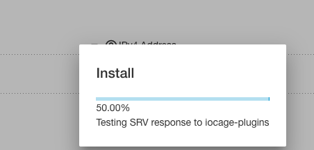

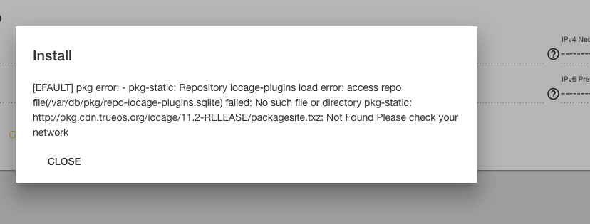

I believe this is related.

pyto
Jan 21, 2017
that package is not found because it does not exist on that server. The correct adres is
http://pkg.cdn.trueos.org/iocage/11.2-RELEASE/Latest/pkg.txz

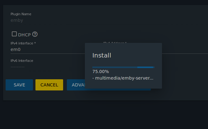

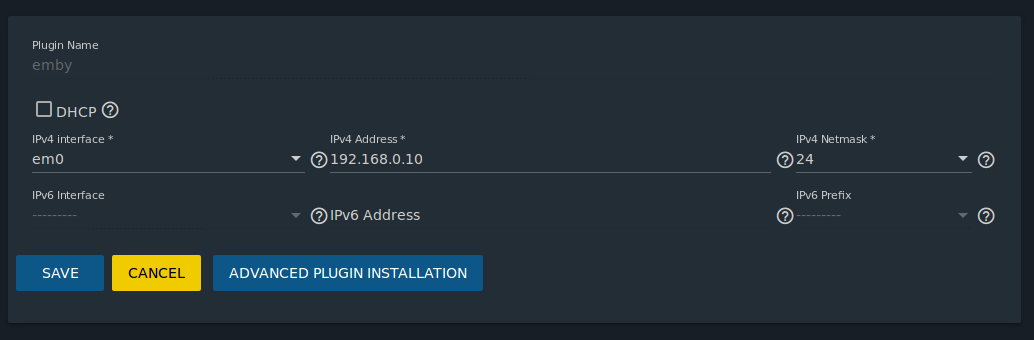

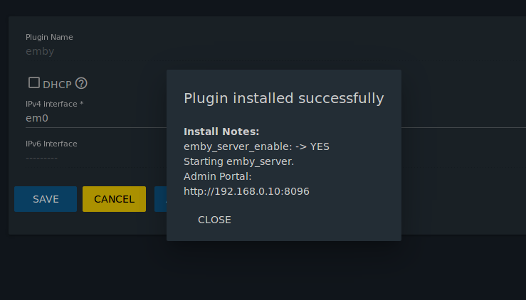

I found a way to solve this plugin installation problem. Ignore getting IP from DHCP and it works. When installing plugin simply uncheck DHCP option. Then select your Ethernet interface. Enter an ip from your network subnet and choose desired subnet mask. Then click save and plugin should be start installing.
[Notes]: If problem exists then edit your resovle.conf file [ nano /etc/resolve.conf]. Delete everything [ there should be an entry search local; (also delete this). Delete everything and enter only nameserver 8.8.8.8.

I found a way to solve this plugin installation problem. Ignore getting IP form DHCP and it works. When installing plugin simply uncheck DHCP option. Then select your Ethernet interface. Enter an IP from your network subnet and choose desired subnet mask. Then click save and plugin should be start installing.
Hi, so this was really helpful because I had originally had set a static IP address the way you did, but I was getting the same error. I was able to ping the internet from my jail by jexec'd to my jail and pinging. You are correct to point out that editing the /etc/resolve.conf file because I have found that there is a bug saving the name servers in 11.x freenas requiring me to set the /etc/resolv.conf file every time I reboot.
Here is where my experience differs from yours. Reading your post is saw you toggled the DHCP -> Static IP. So I toggled my Static -> DHCP and it worked. There is clearly something jenky going on with the jail setup that toggling this setting, which likely restarts the jail network, is fixing I don't think either setting is bad, I think the network is not setting properly on jail creation.
thanks for you post, it helped a lot!
