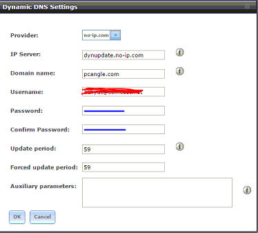

achyut
Dec 23, 2014
I am new for Freenas. I am not able to start Dynamic DNS service. I am using latest version of Freenas (9.3..). And No-ip DDNS service.
