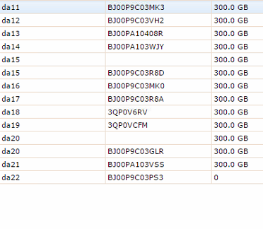

Im new to Dual Port sas. I have 14 15K 300GB sas drives on my freenas and have been connecting them to only one port. Someone explained that they can utilize two and told me to try that. I connected the second port but now the drives show up twice when i go to create any volume. Am i doing something wrong? my chasis is
SuperChassis 846E26-R1200B and it has 6 SAS connections. I read the manual and plugged the sas cable into the correct port (so i think). Any insight would be great

If you have multipath configured correctly you should see a "view multipath" in Storage → Volumes → View Multipaths. This is covered in detail in the freeNAS manual.
