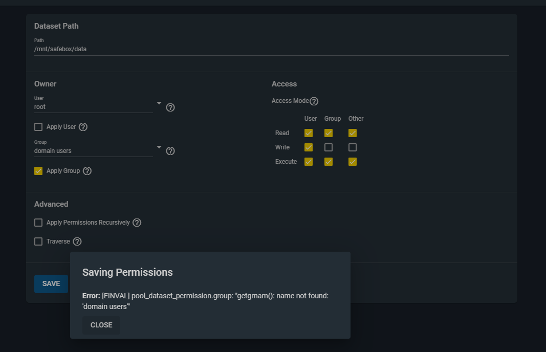

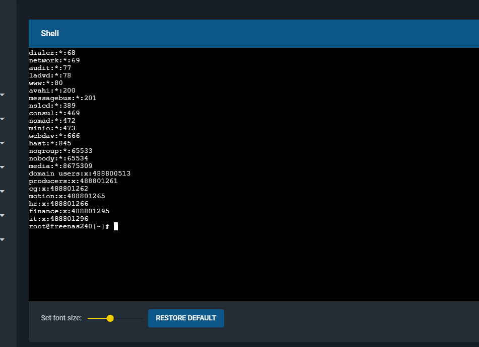

I just build a new NAS with version 11.3-U4.1, after I add it in to my AD, I can see my network user and group in terminal (wbinfo -u and getent group), but I can't find any of them in the permission dropdown manual. Check look the screen shot as follow. As you can see I even type in the domain users in the group field, but I got a error message. I have a old version 11.2-U8, it's working perfect. don't know why 11.3-U4.1 is not working.
Does any one see this before please ring be a bell.

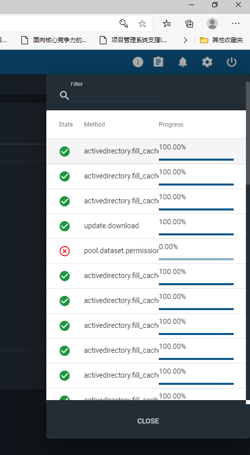

Behind the scenes middleware is calling `grp.getgrnam()` on the username you provided. It's failing with the error "name not found". Did you join through the GUI? What was result in the task manager (top-right of screen)?

I got a error state in the task manager. But all other task is get passed.

Something may be wrong with idmap settings. What is output of getent group "domain users"? Post output of "testparm -s".
Here is the out put

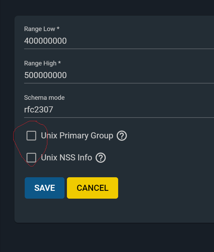

idmap config ddsh: unix_primary_group = True
idmap config ddsh: unix_nss_info = yes
idmap config ddsh: schema_mode = rfc2307
idmap config ddsh: range = 400000000-500000000

^^^ Have you set a GID inside your AD schema for this group, and is it greater than 400000000?
Yep, that is the number I put in there, also, now the user and group shows up in the drop down manual. What I did is uncheck those two option.
Thanks for the help.
