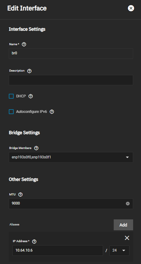

Does bridge interface handle failover automatically?
eroji
Feb 2, 2015
140
I created a bridge interface br0 which both ports on my NIC are member of. The static IP is configured on the bridge interface and I only have 1 of the ports on the NIC currently connected. My question is, if I connect both ports to the same network (VLAN), would it automatically handle failover? Meaning if one of the ports fail for whatever reason the other one should take over?
