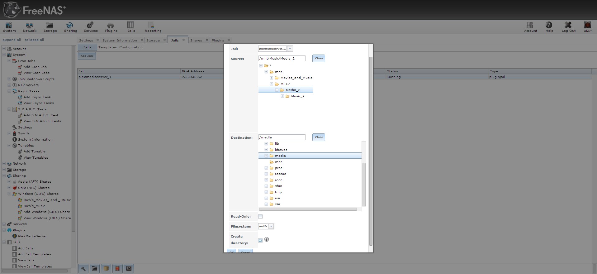

I've added the new mirrored 1TB pool and it's showing as a Windows share, however in Plex media server I can only add folders from the 4TB pool. I'm presuming I've done something wrong with the plugin jail, but I can't think what.
I'm selecting the new Pool in the Jail/add storage/source window and media in the destination window. Am I doing something wrong or missing a step?
(Image of what I'm selecting attached below)

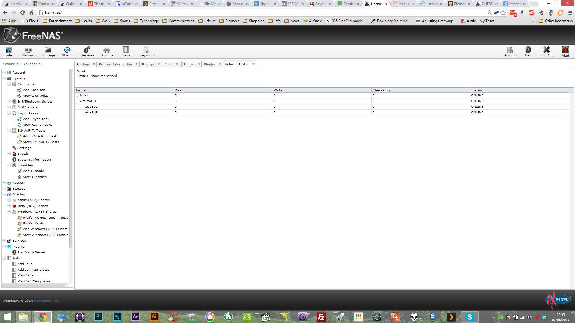

I'm not sure what you're saying is wrong. What is the output of "zpool status" (on the FREENAS side, not in the jail).
CraftyClown
Apr 5, 2014
214

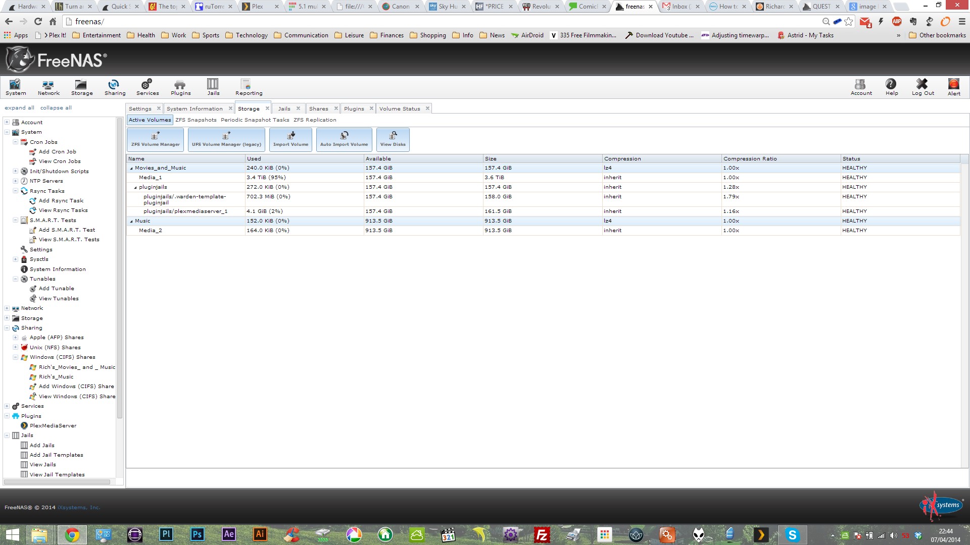

This is how my volumes and jails are currently laid out...
DrKK
FreeNAS Generalissimo
Oct 15, 2013
3,630
Sir:
Something is wrong. YOu said you had a 4TB pool. You stated that were going to add a 1TB to it, presumably as a new pool.
I see only one pool. There has been a miscommunication somewhere. What, PRECISELY, have you done? I think you may be using words in ways that are not correct, and thus confusing me :)

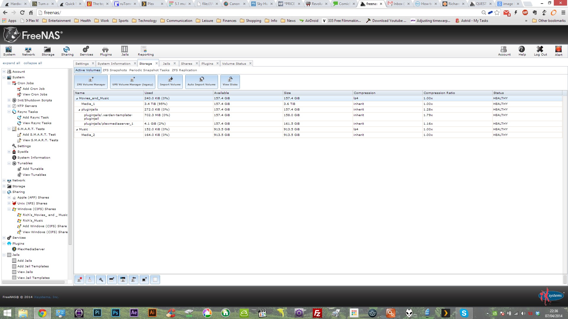

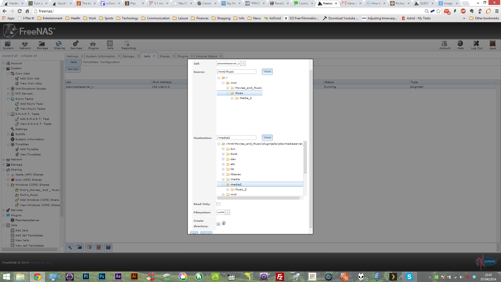

Sorry DrKK, I think I've cracked it :D
I needed to add a new output directory, rather than selecting the existing media directory, like so...

Nope, I'm pretty sure I've got the two pools set up correctly. The 4TB one is called Movies and Music and the 1TB one is just called Music, as in the below screenshot
Sorry I'm not sure what I explained incorrectly to confuse you. I'm afraid I'm new to this :oops:
I have the shares and plex working ok, but are you saying it looks like I have my ZPools set up incorrectly? I think I am confused now!
