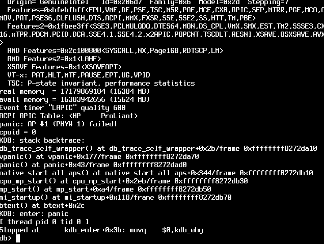

I've trying to install FreeNAS-11.2-U4.1 via usb all day but i'm getting panic errors, is there a way around this. See attached image.

Found the problem, the system doesn't like the Kingston DT50 16GB, seems to be fine with a different usb stick.
