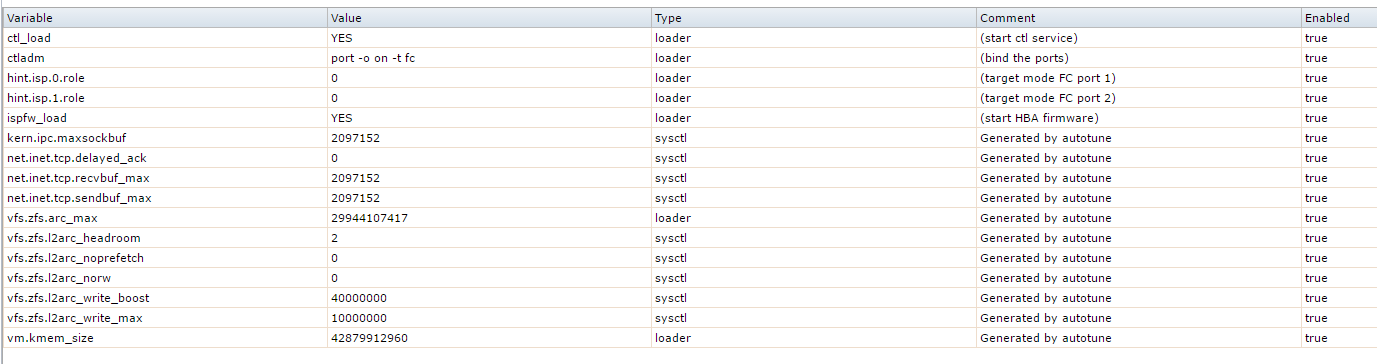

M@TT
Mar 22, 2016
16
Ok.... so enabling auto-tune and rebooting is in fact giving me the same results in speeds (174MBps). Here is a capture of what is in my tunables after enabling auto-tune. I will keep digging/testing....

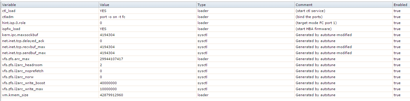

jgreco
Resident Grinch
May 29, 2011
18,680
Do me a favor and double the 2097152 values, and reboot (not strictly necessary but the easiest way to propagate the changes). If that betters your speeds, it gives us a direction to look in.
M@TT
Mar 22, 2016
16
ok... so looks like I am seeing same speeds yet with those changes and a reboot. The only thing I am curious about is how much of a performance hit having encryption on will play into this? I don't ever see heavy CPU during my test so I never thought this could be a bottleneck.....but maybe I am wrong there.
