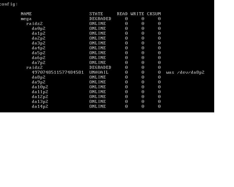

The problem is one of the disks was failed and we couldn't start the server, so we removed the disk and the server can boot normally. but it shows the alert : The volume XX (ZFS) status is DEGRADED
Then we bought a new drive and I just insert it to the server.
Now from the gui-zpool status, this disk here show UNAVAIL
raidz2 ONLINE
da0p2 ONLINE
da1p2 ONLINE
da2p2 ONLINE
da3p2 ONLINE
da4p2 ONLINE
da5p2 ONLINE
da6p2 ONLINE
da7p2 ONLINE
raidz2 DEGRADED
4970748511577484581 UNAVAIL
da8p2 ONLINE
da9p2 ONLINE
da10p2 ONLINE
da11p2 ONLINE
da12p2 ONLINE
da13p2 ONLINE
da14p2 ONLINE

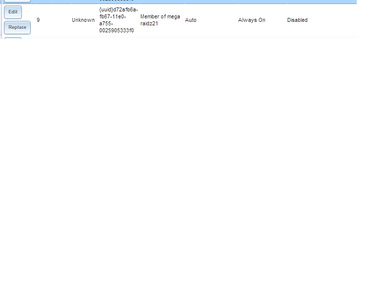

and from view disks here show unknown.
9 Unknown {uuid}d72afb6a-fb67-11e0-a755-0025905333f0 Member of mega raidz21 Auto Always On Disabled Disabled true
How should I do to see the new disk and replace it?

Also this 4970748511577484581 UNAVAIL drive was da8p2, but now the next drive took it place. how could I resolve this?
Thanks

Correct, the daXX number increases sequentially for your drives. If da6 fails and you reboot the drive that was da7 will now be da6, da8 will be da7, and so on.
The failed disk should have a "replace" button next to it. Click the replace button and choose your new disk. Resilvering should then begin. After that's done(which could take some hours) you'll have to "detach" the failed disk to remove it from the zpool permanently.

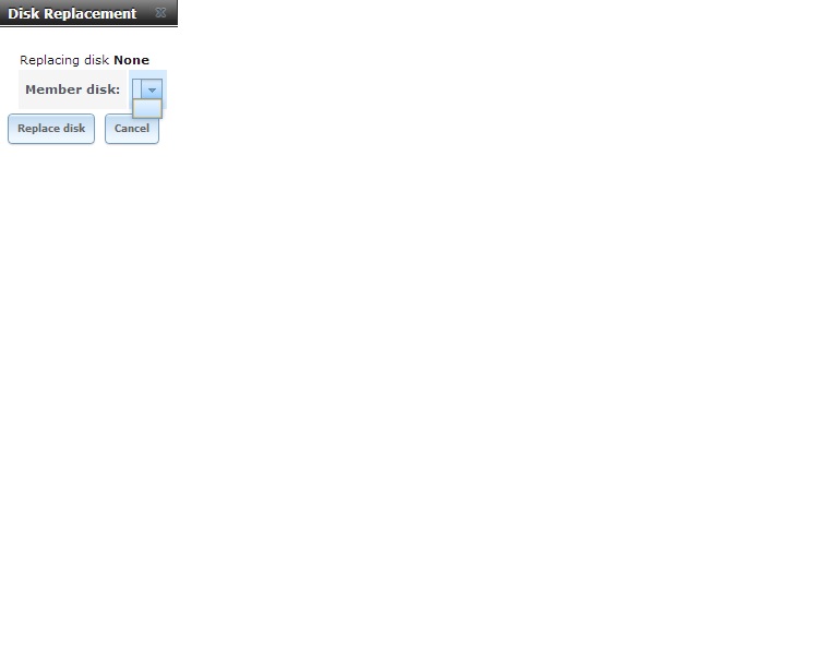

As I mentioned above I just insert the new disk to the DA8 spot (I removed the failed disk), now from the GUI if I click the replace I can't see the drive, and from the zpool status, it's showing like this.
Do I have to do restart the server in order to see the disk?

It looks like you do need to reboot.
cyberjock
Inactive Account
Mar 25, 2012
19,525
When you do I'd go into your BIOS and make sure your SATA controller is set to AHCI mode. If you are using a HBA/RAID controller you should have AHCI set in there as well.
