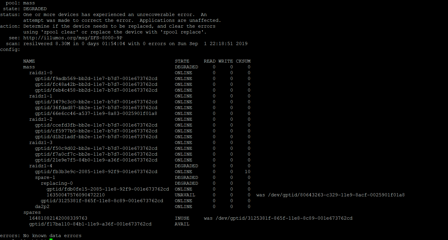

attached zpool status in image I cant save a txt version it seems

the confusion at the moment is that is is saying it is replacing the failed disk with another (Bold) and that the spare is in use, but it has been in this state for ~2 weeks now and the replace just isnt happening. i have had disks fail before and did all work through the UI and it was fine.
spare-1 DEGRADED 0 0 0
replacing-0 DEGRADED 0 0 0
gptid/fdb0fe15-2085-11e8-92f9-001e673762cd ONLINE 0 0 0
16350047576090472210 UNAVAIL 0 0 0 was /dev/gptid/80643263-c329-11e9-8acf-0025901f01a8
gptid/3125381f-865f-11e8-8c89-001e673762cd ONLINE 0 0 0
it is possible i made a bit of a mistake somewhere but i still dont really know which commands will get be out of the pickle.?
Sep 2, 2019
4
thanks for the above I think I now have a solution that looks to work in test.
zpool remove 16350047576090472210 (this will remove the old artefact that was left after the replace.)
this leaves just a spare and the new disk
zpool remove gptid/3125381f-865f-11e8-8c89-001e673762cd (this will remove the spare from the pool and return it to its real location as all is back online now.
the first step worked in test and things a nolonger degraded but the spare is still in use so the second step should remove the spare as welll.
does this sound right.
9,700
Replacing is exactly what a spare should do... the resilvering is complete (although was only a fe MB according to the status output... don't think too much of that as data distribution in the pool isn't necessarily even).
You now need to decide as I mentioned if you want to replace the failed disk permanently with another one and return the spare to the spares list or if you just want the spare to permanently replace the failed disk... the procedures for those two options were in the links.
