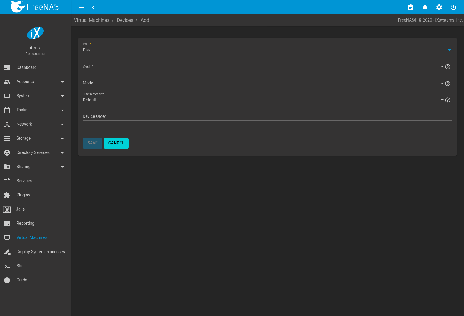

No, it's not possible to pass through a disk device to a bhyve VM. What is possible is to pass a ZFS zvol through as an AHCI or VirtIO device. It's also possible, although a bit indirect, to pass a zvol through as an iSCSI volume, assuming the VM has an iSCSI initiator.
For example, see the 11.3-U5 Guide, Section 18.3.3:
