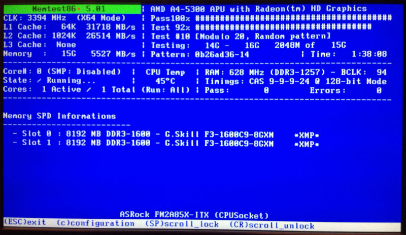

I will run the Memtest86+ by today.

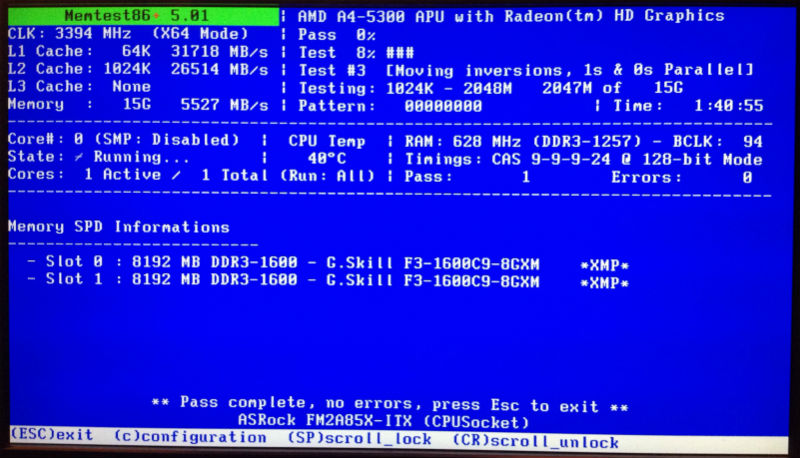

Memtest86+ passed without errors.
The first attach picture was taken when test nearly finished.
2nd picture was taken when start 2nd test.
Look like my RAM did not run at 1600 MHz may be I need new MB BIOS?

Let it run 2 or 3 pass to be sure, and if the result is correct, replace the SATA cable of ada4, and then launch a scrub.
This is the only idea I have at the moment.

Thanks SmallGuy. Three pass test will be performed. Then, I will replace the ada4 SATA cable next.
naa41
Jan 28, 2014
18
After passed three times MEMtest86+ without error, I replaced ada4 SATA cable then alert warning go GREEN. In addition, "zpool status" showed no CKSUM error.
