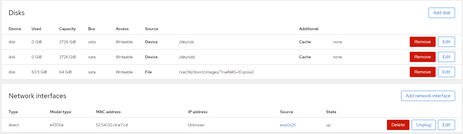

I am newer to the Linux environment. I am installing in a VM on an Ubuntu Server 20.04, using TrueNAS-12.0-U8.iso via cockpit. The initial installations goes through super smooth. I select my 64GB drive, the 16GB swap file, and the installation goes through w/o a hitch. By the time the system boots for the FIRST time, the disk is showing 63.9 of 64GB in cockpit. The entire system comes to a crawl. There can be 5+ minutes between me entering selections in the CLI and anything happening. I also start receiving Traceback errors in the console. (VIA Cockpit -> Virtual Machines ->myVM -> Console ) They are socket.timeouts I'm assuming from not being able to configure my Network Adapters. These timeouts appear to be preventing me from configuring the Network adapter. (Im not sure how to copy/paste these errors, as I'm in a console through the WebUI and the network adapter isn't configured yet for me to be able to SSH in) When I do the selection (1) FOR Configuring Network Interfaces, it can hang for any number of minutes, just for the socket.timeouts to come through and kick me back to the initial selection menu. (1-11). So back to the original reason for the post. Should my boot drive be filling up immediately after installation? Is that the actual cause of these timeouts, causing the inability to config the adapter, because it cant write the data? Any suggestions as to what try / do next would be greatly appreciated as my Linux background is so shallow I'm stuck already. Thanks!
Other Random Crap I've Tried:
1 - Fresh install, new disks, new vm, all the way from start to finish VIA Cockpit - All 3 times exact same issue.
2 - New ISO image - Same issue

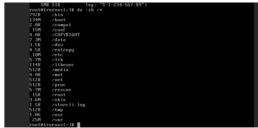

find / -type f -size +100M is not finding anything
find / -type f -size +10M is scrolling off my screen (and I'm still stuck in console so can't scroll up.)
Finally was able to find a command that kept all the output on the screen: Ran "du -sh /*"
Doesn't appear like 64Gb is actually used.
My stump-ification continues.

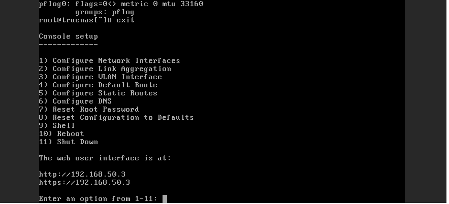

After smashing my face on the keyboard for an hour I was able to set the Network Adapter *I THINK*. It is telling me the web interface should be available but I can not access it via web browser. Disk space issue has not been resolved as the previous screenshot makes it look like its not actually full? Guidance appreciated.

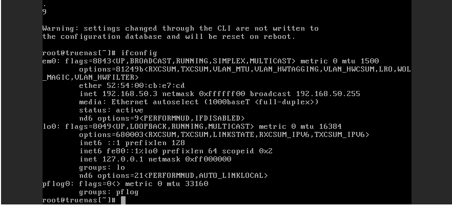

Any idea if this is a display error or is my netmask boned?
/etc/rc.conf files gets overridden on reboot.
doing things like:
ifconfig em0 192.168.50.3 netmask 255.255.255.0
has no effect.
It's saying the web interface is up but I can't get it it.
JuJu142
Mar 2, 2022
12

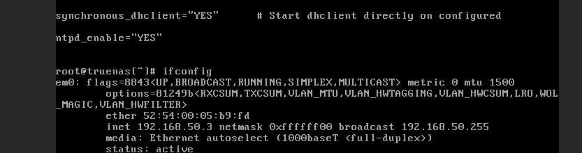

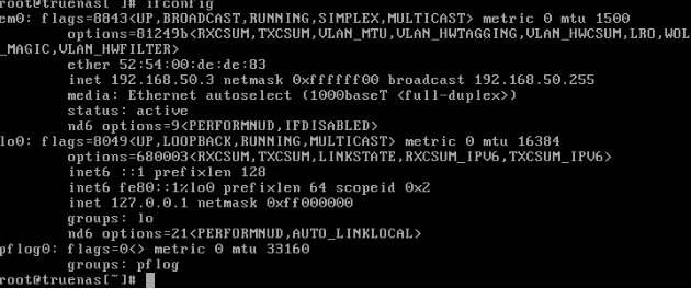

Welp, I'm to the WebGUI! When configuring ipv4 ip i had to enter 192.168.50.3/24 rather than just 192.168.50.3 hitting enter, then entering the subnet 255.255.255.0. This for some reason made the difference. Thought /24 = 255.255.255.0 but for some reason the way you entered the info through the prompts made a difference.
JuJu142
Mar 2, 2022
12

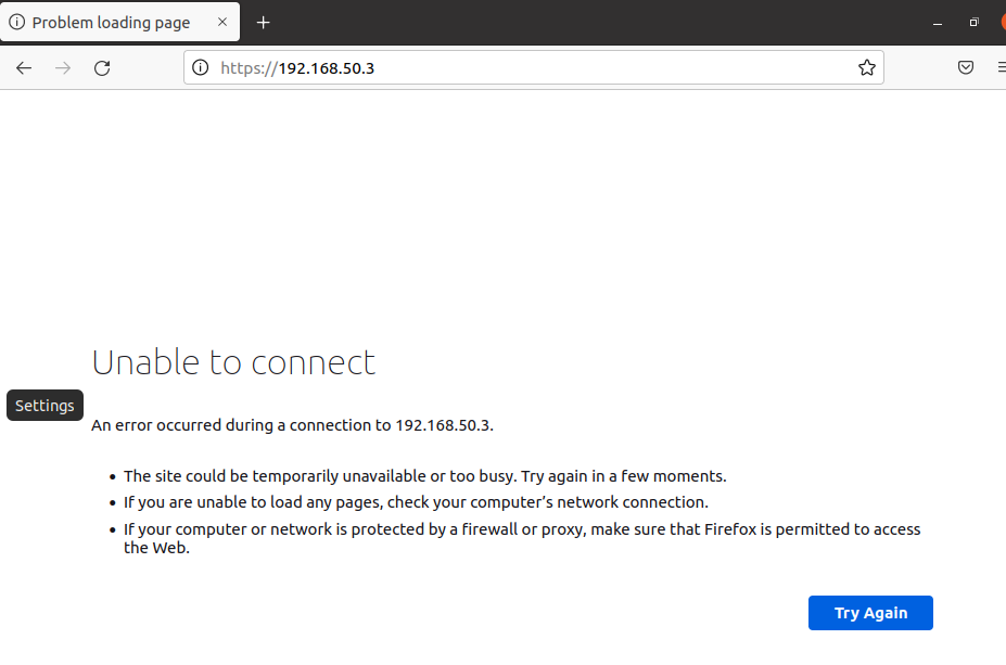

Welp it shows I can get to the web GUI but I can't actually load it. Any suggestions on how to trouble shoot this? Router shows the box connected to it with no issues. CLI says the web gui should be up. Teste from 3-4 devices.

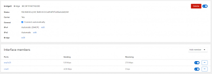

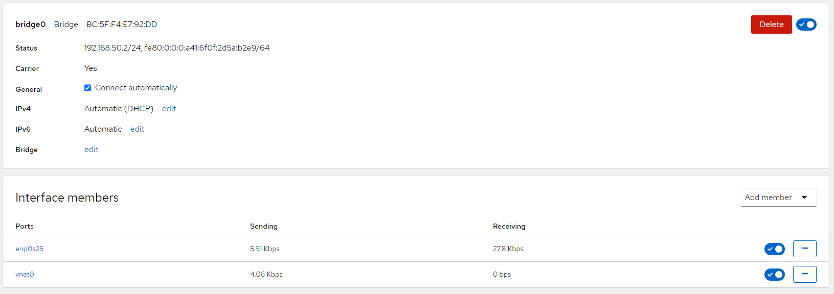

I'm stubborn, so far so good switching the Network adapter over to a bridge. Previously it was set to a direct attachment to the NIC, could get an IP and show an active status in ifconfig but could never hit the web GUI. Switching it to a bridge seems to have fixed that communication issue.
