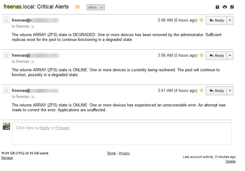

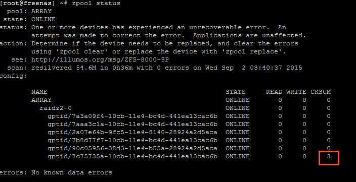

Hello,

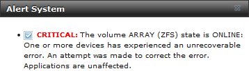

I've woken up to an email that one of my drives has dropped out, but unfortunately the email alert does not name the drive or port which did this.
You can see the critical alert does not state the name of the device which had the issue either.

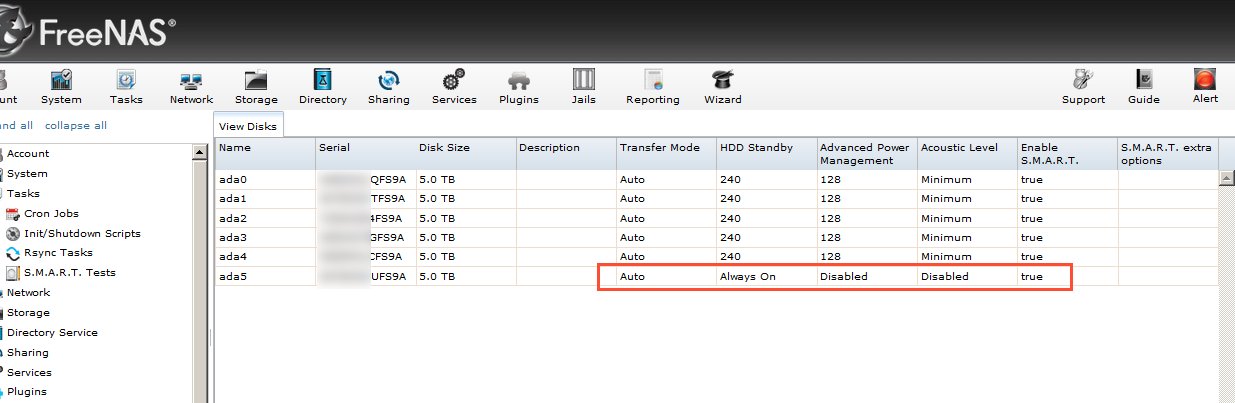

The only indication I have of which disk it is, is one of my disks has "reset" it's settings.
I hate to criticize you guys because, a. I've never "paid" for the product and really like it and b. I never know if I'm doing something wrong?
However,..... to the layman this seems cut and dry, more information would be really helpful to an end user here, for diagnosing issues.
Can anyone please advise?
