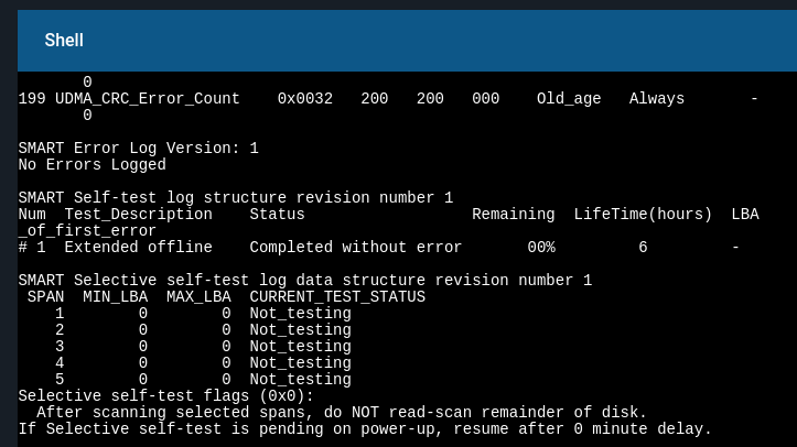

RaidPirate
Sep 25, 2020
14
You have to go to the commandline and run the folowing (replacing the "ada5" with the name of your disks)
smartctl -a /dev/ada5
Thanks - really useful. I'm seeing this. I presume this means disk 6 is ok?

c77dk
Nov 27, 2019
468
Yes - and no. "Yes" because it has managed to do a long scan, which i always good, "no" because even though the disk can do a long test and think everything is ok, you can have some disturbing values in the counters (the part you have omitted in the top)..
