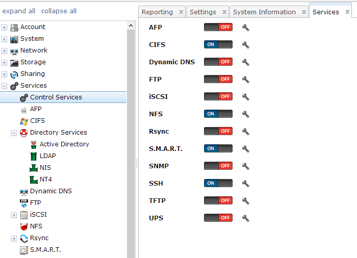

just update from 8 to 9.1, and after active directory service configuration, i can't find the option to turn on this feature in "Services → Control Services"
can anyone have any idea about this issue?
screen shot:

I confirm this issue. I have been using the active directory service successfully on 8.3, so I was surprised at the lack of a button in the GUI on 9.1. The actual configuration dialog box is the same as usual. I am running build FreeNAS-9.1.0-RELEASE-x64 (dff7d13) under ESXi 5.1u1.

Found solution in the official documentation at http://doc.freenas.org/index.php/Directory_Services
NOTE: at this time, only one directory service can be configured. That service must first be selected in the System → Settings → General → Directory Service drop-down menu. Once selected, a Directory Service entry will be added to Services → Control Services so that the service can be started, stopped, and configured.
