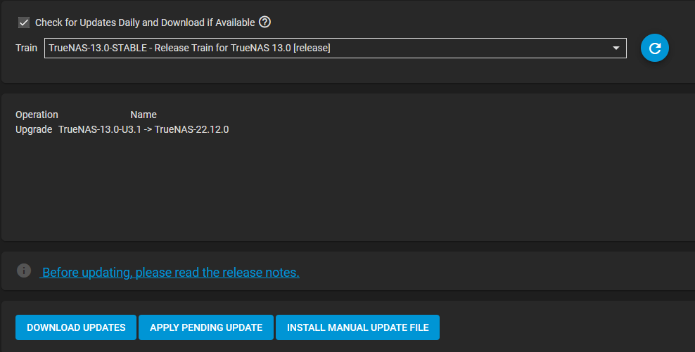

Did a big opps.
Dayve
Nov 24, 2018
21
Thought I would upgrade from TrueNAS-13.0-U3.1 to TrueNAS-22.12.0. After doing so I lost my three jails that I have. So I rolled back to boot from the previous. After doing that Truenas still wants to do the upgrade to TrueNAS-22.12.0 even tho I have selected the TrueNAS-13.0 train.
Is there a way to stop this from wanting to do the upgrade or can I get 22.12.0 to work with my manual jails?

Okay thank you for explaining. Guess I need to stay with TrueNAS-13.0. Would you know how to fix the upgrade issue?

Still wants to upgrade.
"wants to upgrade" means "it's telling you there's an upgrade available." Just ignore it.
