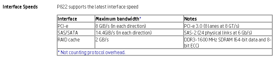

I am running FreeNAS 9.3 Stable on an HP DL380 G5 platform. I have dual X5450 @ 3.00GHz CPU's and 16GB of RAM. I have a Chelsio T3 based NIC in an x16 PCIe slot, and an HP P822 RAID controller in the other x16 PCIe slot. I was doing some testing moving some large files from FreeNAS to one of my ESXi 5.1 servers, and I didn't get quite the performance that I was expecting. I did see the NIC utilization get to about 13%, but I was kind of expecting more. The system load and CPU utilization were all very low during the transfer, and absolutely no swapping taking place. It could also a limitation on the ESXi side, but I am wondering if a move to an HP G6 or G7 platform (ESXi is DL360 G6) would gain me very much. My inclination is no, but I guess I was looking for some confirmation or ways to make sure the FreeNAS hardware isn't a bottleneck. The switch is an HP 5820X. ESXi is mounting the FreeNAS via NFS. I have not pushed the MTU beyond 1500. The test in question relocating a VM from the local data store on the server to the NFS mounted store on FreeNAS. The drives are 25 x 300GB 10K SAS drives configured as RAID 6. The P822 controller has 2GB flash backed cache. I didn't see a way to do JBOD on the P822, so that is why I configured it as a big RAID volume.

The RAID controller is the most modern part of the whole setup. As a matter of fact, they still sell that one. I am reasonably familiar with traditional RAID which is why I have an array that has a bunch of smaller drives instead of 3-4 really big drives. The ZFS thing is new to me.
The array is configured as RAID6-ADG
