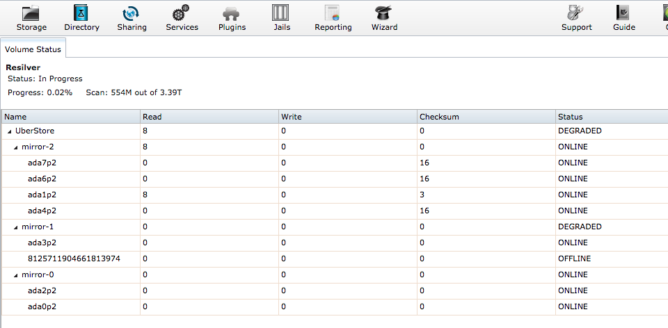

loknar28
Mar 25, 2017
23
GUI View of Resilver

Still resilvering 10 days later. How long is typical?
