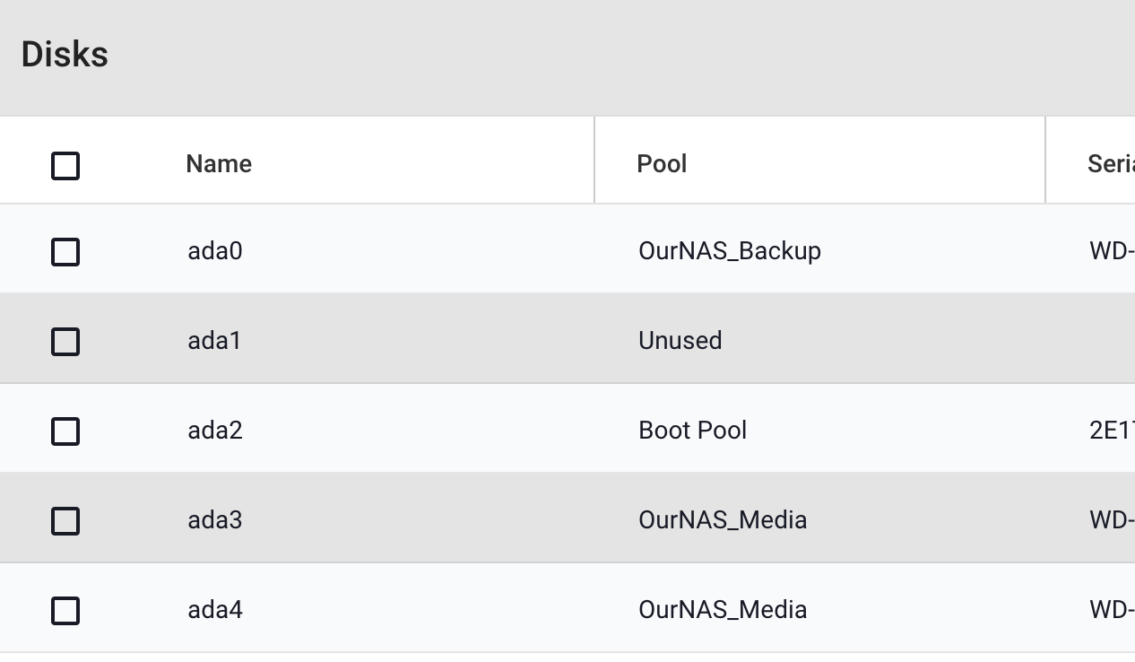

In WebGUI it shows as "unused". The smartctl gives the following:

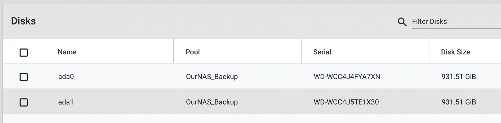

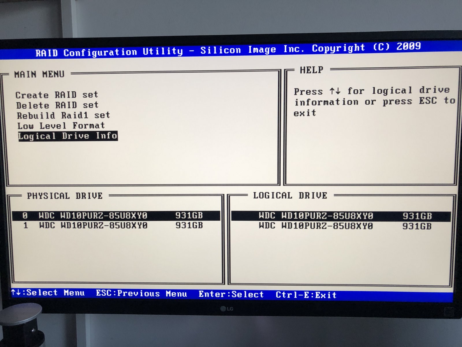

I had built out the RAID card to check it's type. It's a Delock 70137. I have pulled out the card and the SATA connectors I cleaned it too. Before the BIOS menu there is a separated menu for this RAID card and there are booth of the drives shown. But after Freenas boots in the GUI there is still the degraded state and the disk is still unused.

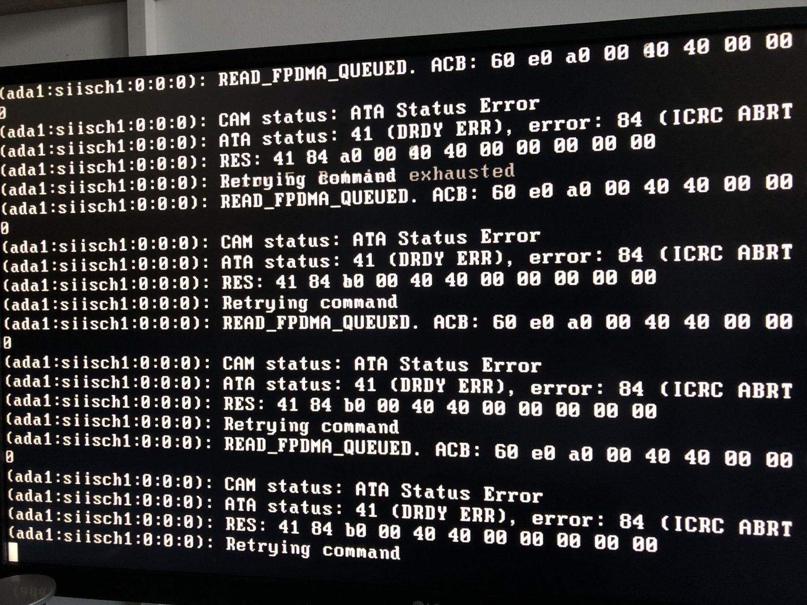

"One more thing": during Freenas boot there is a lot's of CAM status: ATA Status Error messages.. :(

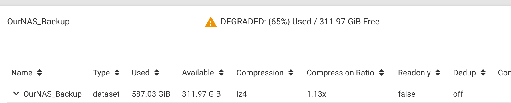

But the pool is still Degraded..
