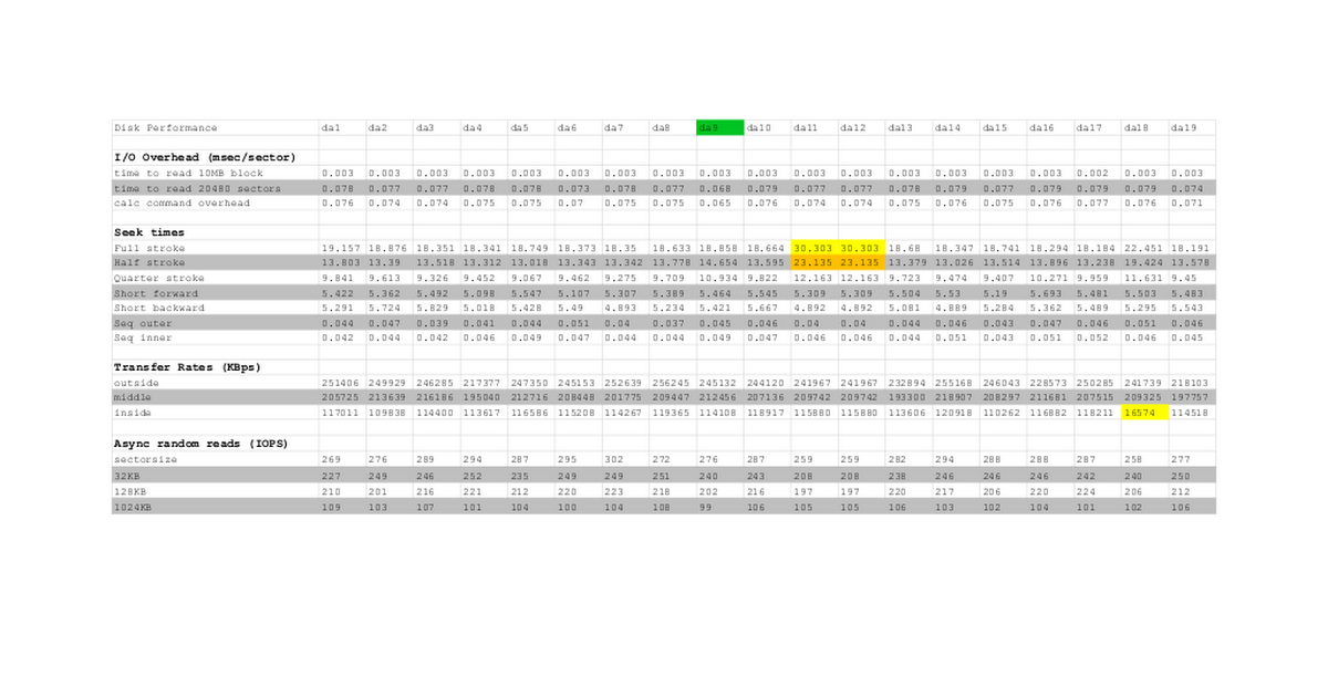

This is the testing I've done thus far. ARC and compression disabled for this testing.
NAS Disks.xlsx
Diskinfo Disk Performance,da1,da2,da3,da4,da5,da6,da7,da8,da9,da10,da11,da12,da13,da14,da15,da16,da17,da18,da19 I/O Overhead (msec/sector) time to read 10MB block,0.003,0.003,0.003,0.003,0.003,0.003,0.003,0.003,0.003,0.003,0.003,0.003,0.003,0.003,0.003,0.003,0.002,0.003,0.003 time to read 20480 ...

Now, I'm cognizant of the disks and their history/known issues. One mention in that they slow down when getting full. They're only about 55% full so I don't expect that to necessarily be an issue. Given the metrics in the link above, my assumption is that, individually, they perform as expected.
