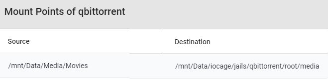

I have done a mountpoint as in the following :
but how do i relate this to the ' Default Save Path:' in the WebGUI ? Do i put the mount point full Destination path replacing the default value "//Downloads" ?

Inside the qbittorrent jail, the mount point is /root/media. Try that as your save path.

an update.
If i put in /root/media as shown:
it will go to \iocage\jails\qbittorrent\root\root\media
so, i'm now trying to put just /media . Let's see, shall update again.
numbertwo
Junior Member
Jul 1, 2018
18
So, yes, /media will do.
Here is the complete picture in case someone needs it:
In the jails mouting points setup, source and destination are :
Source : /mnt/Data/Media/Movies
Destination : /mnt/Data/iocage/jails/qbittorrent/root/media
In qbittorrent WebGui setup:
Default Save Path : /media/
in Windows explorer i am then able to find my media files at : \\{Freenas server}\Data\Media\Movies
Tks.
