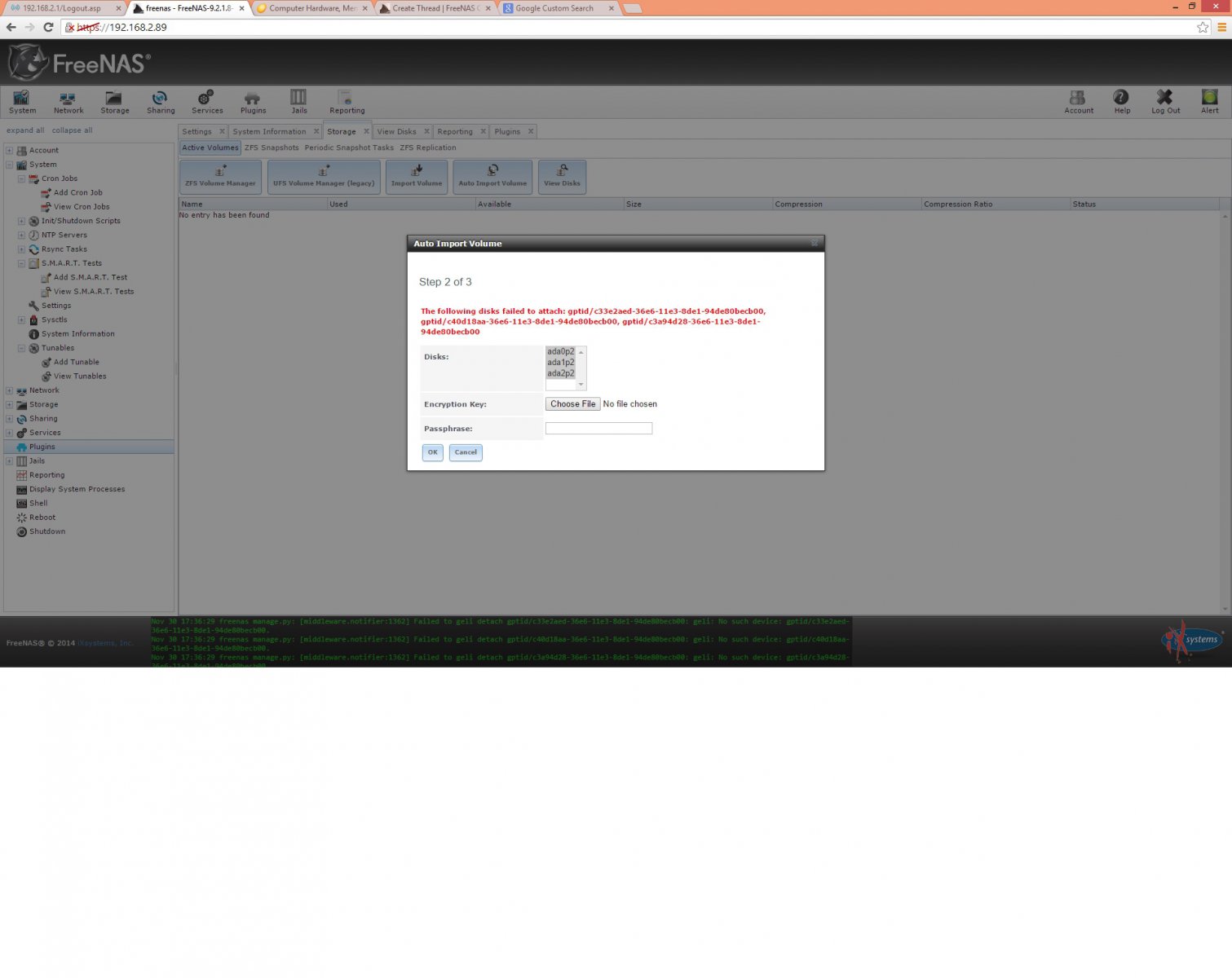

Ok, here is the story.
A couple of months back I decided to build an ITX gaming box for my living room (tired of expensive games and multiplayer fees on consoles). My Freenas Server had 12GB of RAM and I only felt like I needed 8GB. I pulled 4GB of RAM out and restarted the server. There was a short on the motherboard and somehow a socket pin got bent. A few motherboard RMA's later I finally was able to boot up Freenas. However I can no longer unlock the encrypted volume on the server using the key I had been using and my passphrase. This was setup as a RAIDZ5 I believe (9TB total, striped to 6TB). Unfortunately my seagate external backup hard drive also died so I have no backup.
A few things that changed.
  1. I had not taken a picture of the cables when I pulled them all to send in the motherboard so the SATA cables are likely in different SATA connections (hard drive X may no longer be in SATA1). I don't know if this impacts decryption.
  2. Obviously I now only have 8GB of RAM instead of 12.
  3. New Motherboard (same brand and model).
  4. New Freenas version on the USB drive. I was 9.2.1.7 before, the USB is now 9.2.1.8. I had wiped the 9.2.1.7 because my motherboard was no longer detecting the drive (thought there could have been a problem with the USB, turns out it was faulty MB release firmware).
I have tried detaching the drive, rebooting, and auto importing but I get an error (tried based on other forum results). See error below and uploaded screenshot.
  • The following disks failed to attach: gptid/c33e2aed-36e6-11e3-8de1-94de80becb00, gptid/c40d18aa-36e6-11e3-8de1-94de80becb00, gptid/c3a94d28-36e6-11e3-8de1-94de80becb00
And the log below.
Nov 30 17:14:18 freenas manage.py: [middleware.notifier:1362] Failed to geli detach gptid/c3a94d28-36e6-11e3-8de1-94de80becb00: geli: No such device: gptid/c3a94d28-36e6-11e3-8de1-94de80becb00.
I've been without my server for 3 months and it feels like I am going through withdrawals (probably just overwhelming frustration). Any help is appreciated.

I'm relatively new to FreeNAS and haven't worked with many of the linux commands, but would it show any pools if I detached the volume? The volume was showing originally but would not unlock, I read on the freenas forums that people had success with detaching and auto-importing to restore their drives so I tried but it would not decrypt (see the image in my first post). I do not have a full backup to restore as my external hard drive has failed.
