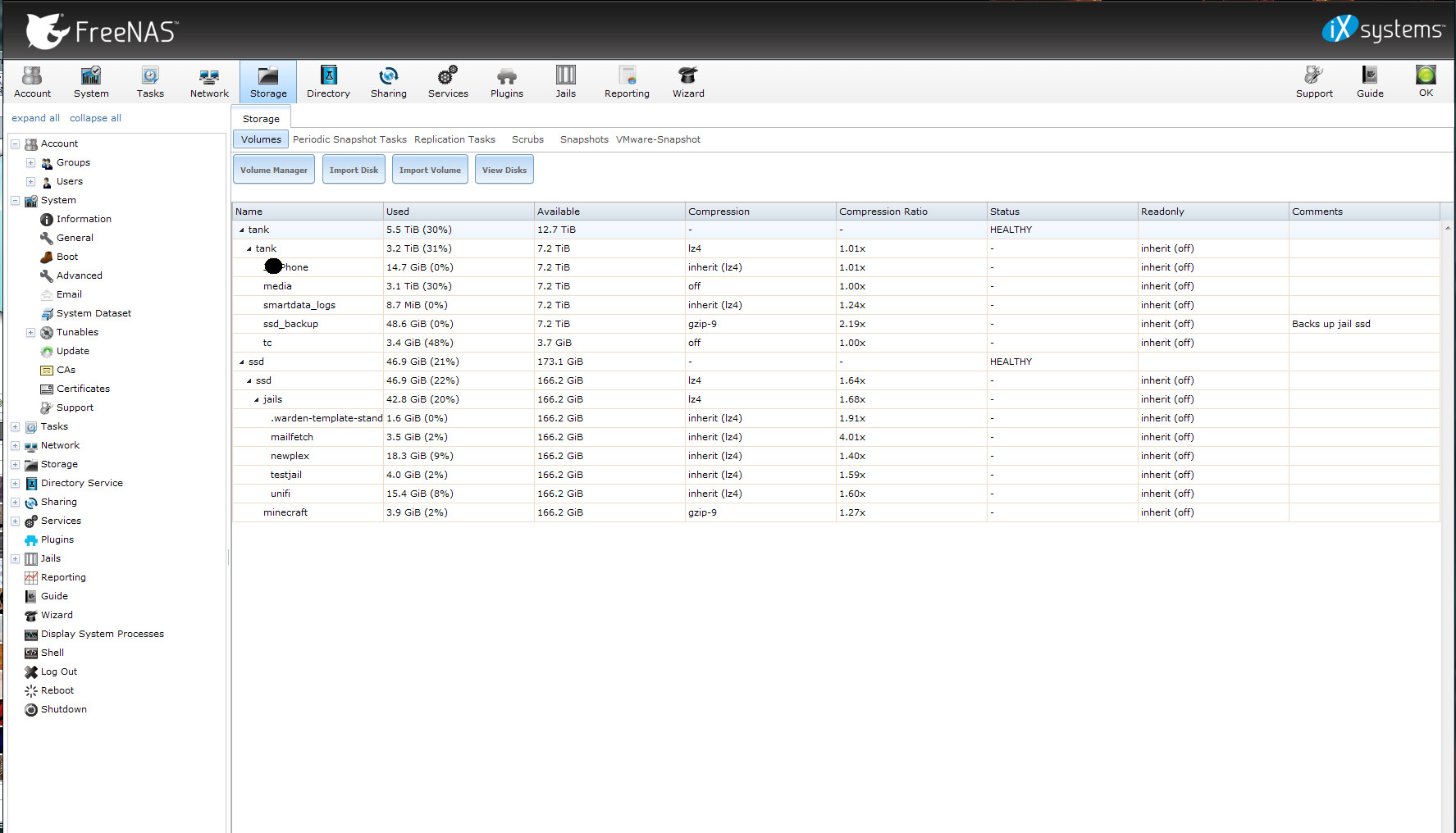

Just to convince you, here's mine. "tank" is a RAID-Z2 with 5x4TB. "ssd" is a single SSD.
15,504
This is totally normal and it has been this way the whole time, you just didn't notice.
More precisely, it's been this way since the release of 9.3. Before that, only one (the pool itself, or the root dataset; don't remember which) was shown.
