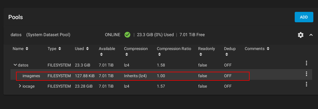

In TrueNAS-12.0-U7, I want to mount the marked dataset (datos/imagenes) in a jail.

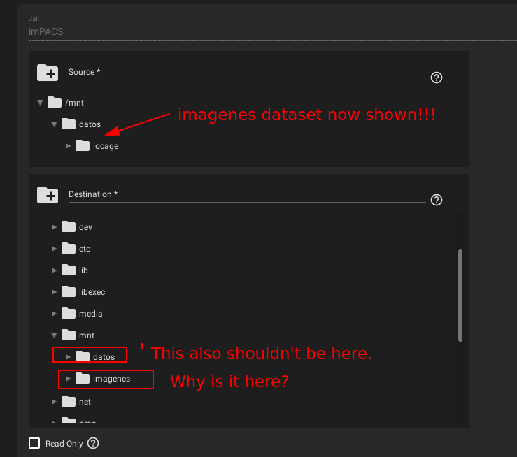

From Jails -> my jail I go to mount_points then add, and I can't see the /mnt/datos/imagenes dataset. Also there's a weird thing, both mnt/datos and mnt/datos/imagenes are listed in the mnt directory of the jail.
What I would like to do (I'm sure I did this on previous releases) is to mount the /mnt/datos/imagenes dataset into the jail.

Follow up. If I go to shell and do an ls /mnt/datos I only see iocage but not imagenes.
