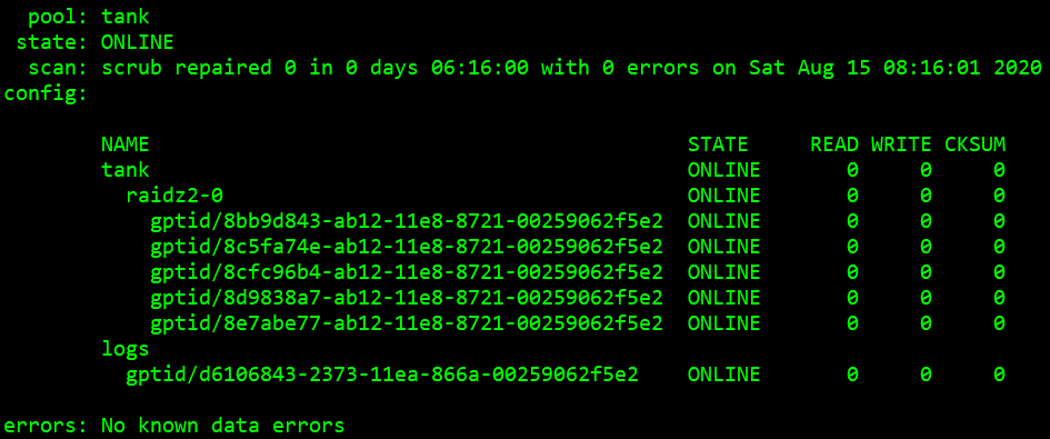

Hi, what is the status of your zpool and when did the last scrub finished correctly?

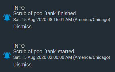

I've never had any scrub errors, and they run 2x month. SMART is fine also.
9,700
We need to see the output from zpool status -v to understand if ZFS thinks there's corruption or not... You seem to be saying there is none, so the chances are that the files were always corrupt.

Output of zpool status -v
