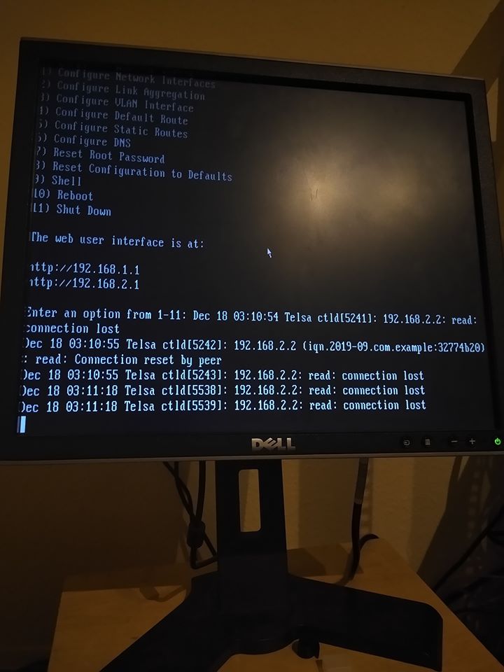

i believe this is a bug. my Console on FreeNAS gets spammed with,
Dec 18 17:47:50 Telsa WARNING: 192.168.2.2 (iqn.2019-09.com.example:32774b20): no ping reply (NOP-Out) after 5 seconds; dropping connection
Dec 18 18:13:07 Telsa kernel: cxgb0: link state changed to UP
Dec 18 18:14:18 Telsa ctld[49704]: 192.168.2.2: read: connection lost
Dec 18 18:14:18 Telsa ctld[2304]: child process 49704 terminated with exit status 1
Dec 18 18:14:19 Telsa ctld[49705]: 192.168.2.2 (iqn.2019-09.com.example:32774b20): read: Connection reset by peer
Dec 18 18:14:19 Telsa ctld[2304]: child process 49705 terminated with exit status 1
Dec 18 18:14:19 Telsa ctld[49706]: 192.168.2.2: read: connection lost
Dec 18 18:14:19 Telsa ctld[2304]: child process 49706 terminated with exit status 1
Dec 18 18:14:42 Telsa ctld[49730]: 192.168.2.2: read: connection lost
Dec 18 18:14:42 Telsa ctld[2304]: child process 49730 terminated with exit status 1
Dec 18 18:14:42 Telsa ctld[49731]: 192.168.2.2: read: connection lost
Dec 18 18:14:42 Telsa ctld[2304]: child process 49731 terminated with exit status 1
iSCSI Storage for XCP-ng i have also tested with 1gig and 4gig LAG as well as 10gig Network and problem is still there also tested on different hardware boards etc. Problem is there in both 11.1 and 11.2. Someone else has had this bug but closed as it couldnt be reproduced. https://redmine.ixsystems.com/issues/7891
As this happens connection is perfectly fine all VMs work, XCP-ng doesnt show anything in the logs about the link dropping.
Network cards tested and produced this issue.
HP NC360T Dual Port
HP NC364T Quad NIC
Chelsio T320E
