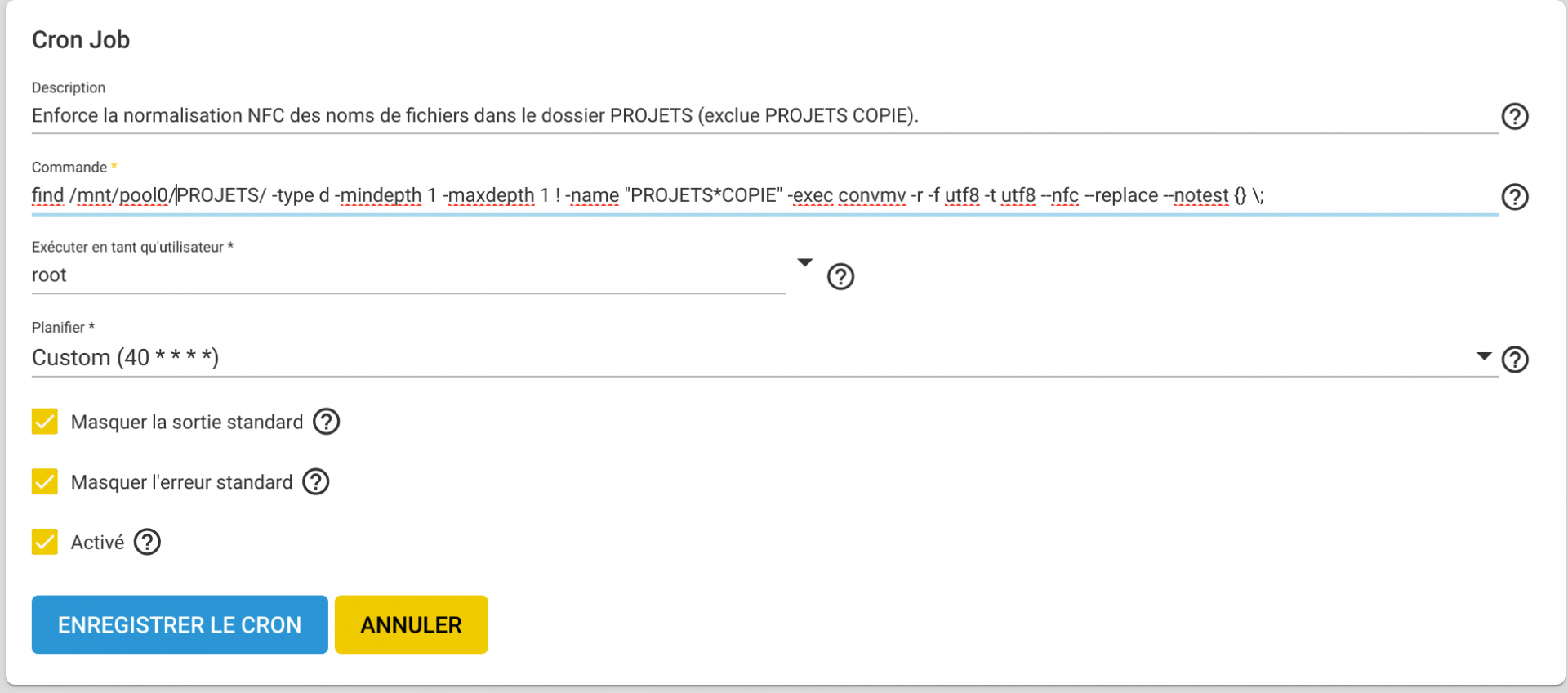

I have a problem since upgrading my two NAS to FreeNAS 11.3. My crons are executed with a random delay and may even be not executed at all.
Task configuration:
Cron log:
This bug occurs for all my tasks on my two NAS. The run you see at 7:40 is the first after a server reboot. After some hours or days of uptime, the cron is even more unreliable (stop to process task or almost all of them).
Task configuration:
Cron log:
