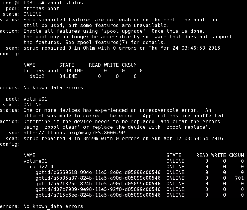

I've attached a screenshot of the result when running a "zpool status". Is that the right command? Is it the CKSUM value on one of the disks that is the problem?
The disk overview on the web interface is not showing any errors, or anything suspicious on any of the disks.

Your hardware is fine. Now that we can see it. ;)
Do take great consideration for danb35 advice and post what was asked so we can try to help you.
Great - I thought so ;) I've used a lot of time in here to find a great hardware-solution :)
15,504
Yes, it likely is. Start a long SMART self-test on that drive ('smartctl -t long /dev/whatever'). Once it finishes (likely in several hours), post the output of 'smartctl -x /dev/whatever' in code tags. This will help determine if the problem is with the drive itself or somewhere else.
Thanks. I have started the self test now. I will return once there is a result :smile:

Just wondering if you're sure you're testing the same disk that showed checksum errors in zpool status. One of my frustrations is it seems everything shows you a different identifier for the disks. Tying them all together is certainly doable, but a pain.
You've got a huge number of raw read errors on that disk (line 66), and it looks like it's exceeded the max temp threshold (lines 79 and 155). But it did pass the extended test (line 130), and if I read it right the errors were correctable (lines 84-85). I'm not sure where that leaves you. Not an expert, but my first impulse would be to (a) make sure the drives don't overheat in the future, and (b) clear the errors as zpool status output suggested and keep a close eye on things.
15,504
Not really. The drive's a Seagate, and they report that field differently. I don't understand or remember the detail, but in short, on a Seagate, the higher that number is, the better.
Definitely--it's seen 59 C, which is way too high (back in my younger and dumber drives, I had a couple of drives in a server in my attic. In the summer. In South Carolina. The highest they saw was 54 C, which is way too high as it is).
Nothing jumps out as problematic, so I'll echo @Glorious1's question: are you sure you tested the right drive? It's certainly possible you did, but we'd want to be sure.

This is from zpool status:
  pool: volume01
state: ONLINE
status: One or more devices has experienced an unrecoverable error.  An
attempt was made to correct the error.  Applications are unaffected.
   see: http://illumos.org/msg/ZFS-8000-9P
  scan: scrub repaired 0 in 3h59m with 0 errors on Sun Apr 17 03:59:54 2016
config:
volume01                                        ONLINE       0     0     0
  raidz2-0                                      ONLINE       0     0     0
    gptid/c6560518-99de-11e5-8e9c-d05099c00546  ONLINE       0     0     0
    gptid/a5b85a87-824b-11e5-a90d-d05099c00546  ONLINE       0     0   705
    gptid/a621326c-824b-11e5-a90d-d05099c00546  ONLINE       0     0     0
    gptid/d07c7909-9e98-11e5-92f0-d05099c00546  ONLINE       0     0     0
    gptid/a715c6ee-824b-11e5-a90d-d05099c00546  ONLINE       0     0     0
errors: No known data errors
And this is from glabel status:
                                      Name  Status  Components
gptid/a715c6ee-824b-11e5-a90d-d05099c00546     N/A  ada0p2
gptid/a5b85a87-824b-11e5-a90d-d05099c00546     N/A  ada1p2
gptid/a621326c-824b-11e5-a90d-d05099c00546     N/A  ada2p2
gptid/c6560518-99de-11e5-8e9c-d05099c00546     N/A  ada3p2
gptid/d07c7909-9e98-11e5-92f0-d05099c00546     N/A  ada4p2
gptid/ad5dd534-7a81-11e5-a03a-d05099c00546     N/A  da0p1
And I ran smartctl -t long /dev/ada1 to start the long self-test, and smartctl -x /dev/ada1 to get the results.
The temperature issue is a long way back, when I build the machine, and did not get the air flowing right inside my case. It should not be a problem anymore, the temperature as I read it is now 29 degrees Celcius.
I have a bonus question, if you guys don't mind. When scheduling my SMART tests, should I schedule different disks at different times, or doesn't that matter?
My instinct tells me you'll just multiply the time the pool spends with degraded performance by the number of drives. Since the pool is mostly limited by its slowest drive (if only a single vdev exists), you're just limiting the pool's performance for longer, about as much as you'd see from doing the SMART tests all at once.
So don't, unless you're looking for learning experiences.
Sorry this is not to be impatient - I just think I didn't press "Reply" when I posted my last post. So I just wanted to make sure that you got a notification on my post :smile:
It is this one.
