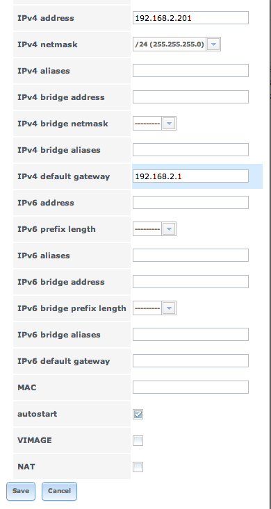

I was able to get it running by deleting the jail and plugin (3.5.3) and reinstalling the new plugin (3.5.3_1). I unchecked both VIMAGE and NAT and verified my network gateway was entered in the jail IPv4 default gateway field (i was getting some weird message about the gateway not found which i mentioned in Announcing FreeNAS 9.2.0-RELEASE). Verified the jail IP was the same as before and that my headless client was pointing to the correct IP. All is working now. I did, however, have to setup the jail storage shares and adopt the backup in Crashplan.

sully
Aug 23, 2012
60
Thanks, that seems to work (although I cannot enter the jail's default gateway since this field is also disabled when unchecking VIMAGE or NAT).
Interesting. This is what I see (see attachment). Have you tried restarting the Jail?

Hi-Liter
Oct 6, 2011
83
Ok, works after restarting the jail. I had the jail disabled and then tried to change the settings. Under those circumstances, it seems to disable certain fields when checking/unchecking NAT.
