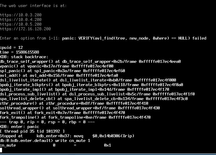

Updated to latest posted build. Created a clone of a replicated dataset from an 11.3 FreeNAS to test SMB/SMB Multi-streaming (works; atl east seems similar to what's in 11.3 since multi-streaming is still not supported).
TN12 pool has dedup enabled; 6x2 vdevxMirror hdd, 2xMirror nvme m.2 1tb for metadata, 1tb nvme M.2 for l2arc, 2xmirror satassd for ZIL (but not enforced), 192GB ECC RAM; Supermicro box w Intel 4210.
Created SMB of that share, all seemed to work fine. Took out the share, disabled SMB, went to delete the cloned dataset and box rebooted unexpectedly. I'd provide logs if I knew where to grab.

...and it's repeatable; dataset was still there after the box rebooted itself, attempted to delete it again, and it bounced itself again.

Anyhow, updated to latest as of today, attempted again, did a capture of the console, pasted below.

Updated to latest nightly (today) and still does it. Going to try dropping the dataset via CLI when it finishes booting back up =/
CLI blew chunks on it too. Looks like I'll blow out the pool and not do that again until release. =/
