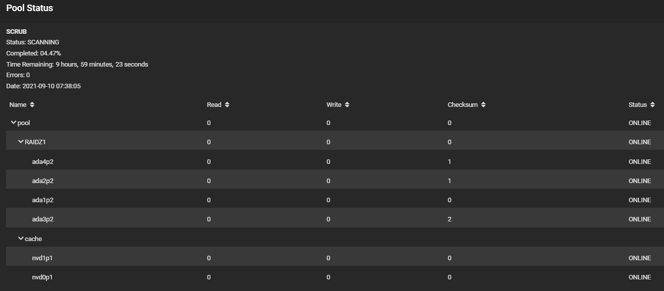

Your first output from your original post shows 0 checksum errors.
However, your second screenshot shows 4 errors (throughout 3 different drives.)
You may in fact be facing a different issue then.

But since you do have checksum errors, it's probably more than just phantom files/folders that don't exist anymore.
Are you using native encryption by any chance?
You might have to resort to starting from a backup if the "cancel within 1 minute trick" doesn't clear it.
