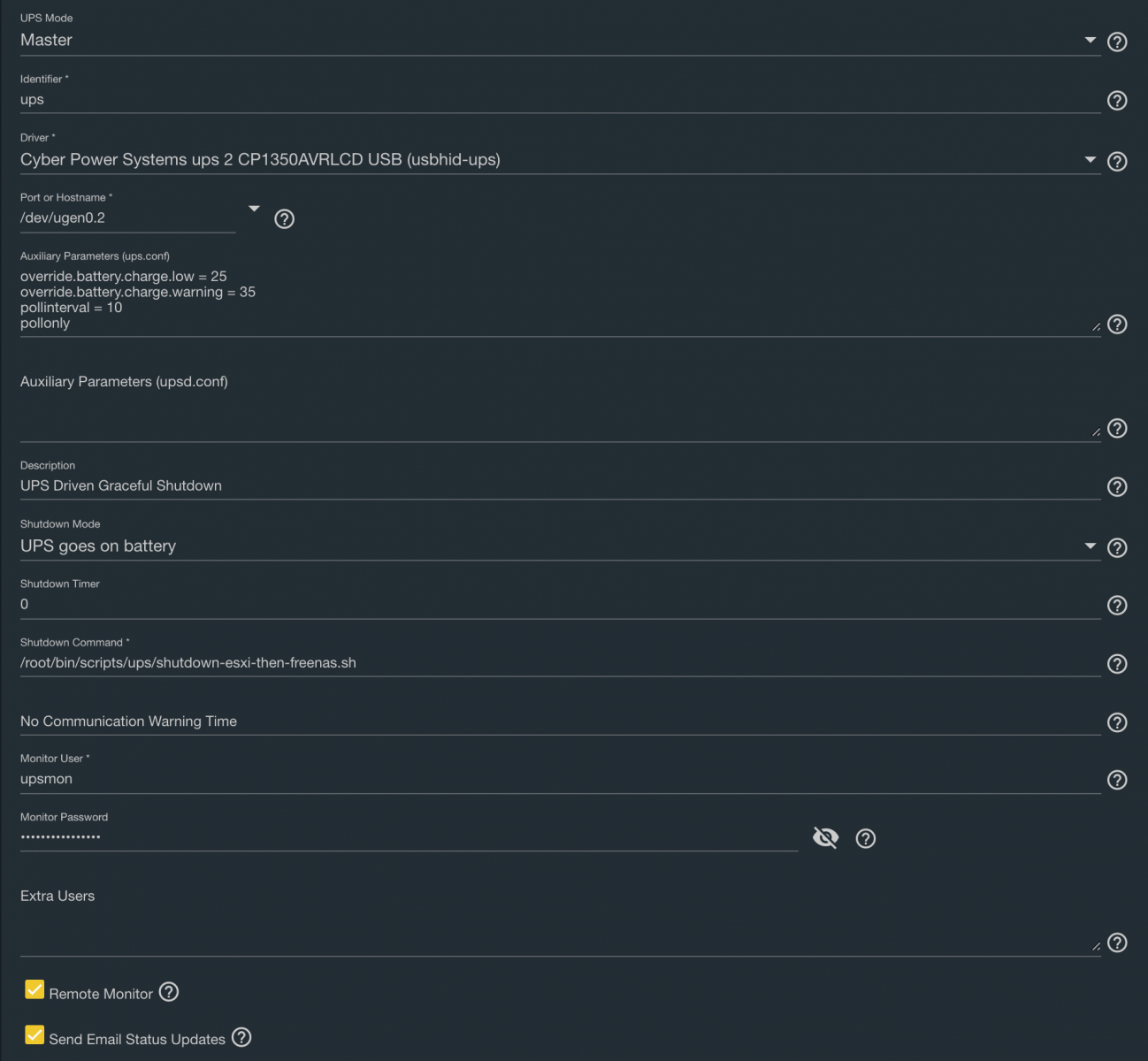

@Spearfoot I modified your scripts and from command line, I can pretty easily shutdown my machines gracefully but for a reason beyond me, upsmon isn't doing so when I test an ONBATTERY event. It looks (from absence of log activity) that the script never gets called. Is this what you encountered and referred to here? If so, not sure how to proceed with the script method.
My daemon.log shows the following:
May 13 20:40:51 freenas upsmon[61011]: UPS ups on battery
May 13 20:40:51 freenas upssched[33249]: Executing command: EMAIL
May 13 20:40:51 freenas upssched[33267]: Timer daemon started
May 13 20:40:51 freenas upssched[33267]: New timer: SHUTDOWN (0 seconds)
May 13 20:40:51 freenas upssched[33267]: Event: SHUTDOWN
May 13 20:41:06 freenas upssched[33267]: Timer queue empty, exiting
Note: I also see a bunch of these that I've been trying to eliminate by reducing the poll interval setting (see attached UPS service settings)
May 13 20:44:20 freenas usbhid-ups[60985]: libusb_get_string: Unknown error
