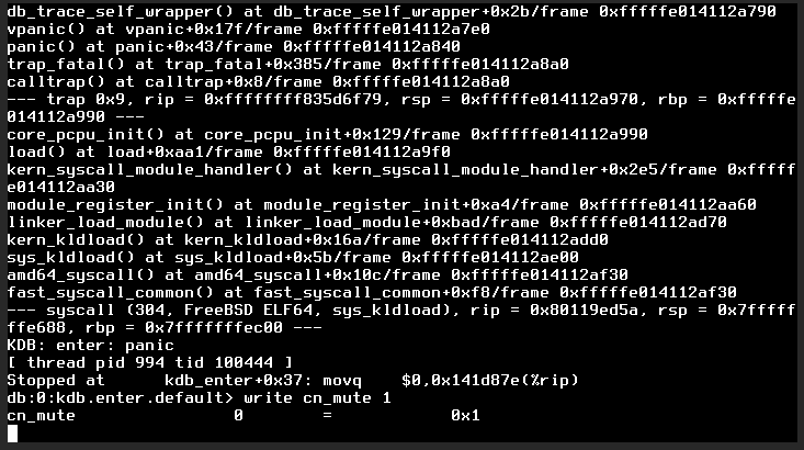

Hello,
I have been running core u1.1 for testing purposes, however the u2 version after install gets stuck on first boot. (screenshot attached)
During this "stuck" state, it uses 34% of 4 cores i gave it consistently and a bit of io as well for about 30 minutes already without a change.
I'm running it under a vm in proxmox, with 28GiB of ram, cpu type host with 4 cores, boot virtual disk is running at directsync.
Thanks for help.
Direct allocated disks from the host are known to misbehave at times. The only proven way to allocate disks to the guest is via a PCI passthrough of an HBA with connected disks.
I installed scale for basic vm feature.
