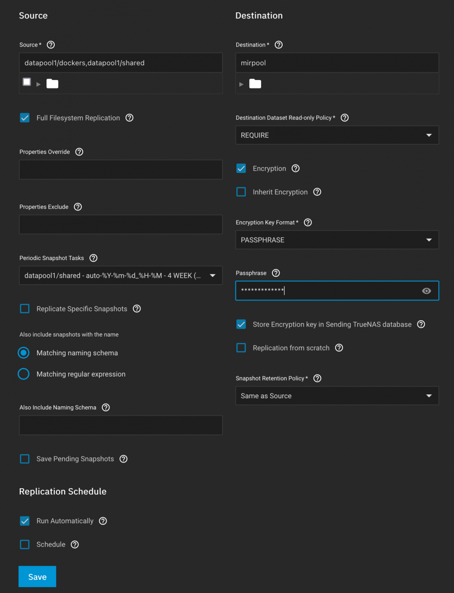

I have tried copying the data to the new server with a replication task but that errors out with the following:
And this is what my replication task looks like:
r/truenas - Copying data from unencrypted dataset to an encrypted dataset on new Truenas Scale server
Am I doing something wrong? Is this the best way to copy the data to my new server?

- mirpool (encrypted pool)
Is mirpool already encrypted?
Uncheck inherit encryption, or try with an encrypted dataset as the target /mirpool/newdataset/
Or uncheck inherit and set a new encryption in the replication task. But keep in mind that the datasets cannot be unlocked via the parent in that case.
Personally I prefer one snapshot task and Replication task per dataset.

You might try unsetting the Include Dataset Properties option in that task and try it again to see if that works.

Thank you gentlemen.
I took @chuck32's advise and unchecked inherit encryption and set a new encryption on the task. Only problem there is going to be that the parent pool (mirpool) and the child datasets will have different encryption settings. I don't think that's a big deal because I can always go back and change parent's encryption settings (please correct me if I'm wrong with this assumption). I posted a screenshot of my settings below in case this helps anyone else in the future.

@Bonnie Follweiler: to answer your questions, my old server is on TrueNAS-23.10.1 and the new server is on TrueNAS-23.10.2. However, I had selected Full Filesystem Replication when trying again. It appears to be working so I didn't stop it. Is that going to pose an issue?
Here is the screenshot of the settings that I used:
