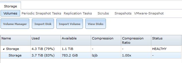

I currently have 6 1TB drives in a zfs1? config. Compression is lzjb:
index.php
I have been told how this is set up is wrong, and that is why I want to start over. I am buying some 4TB drives and will have them in a cyberjock approved configuration.

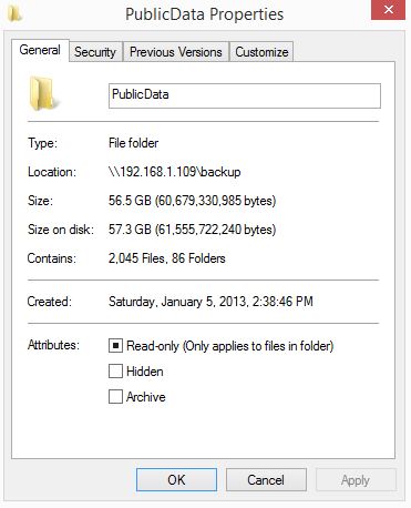

The issue I'm running into is I'm trying to copy my directory "Public Data" It shows up as having 56.5GB of data.
index.php

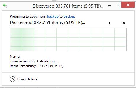

When I try to copy this over to my backup hard drive, or a internal 4TB drive on my main computer, it shows this:
index.php
I'm not sure why it shows such a large amount of data--has anyone else seen something like this?

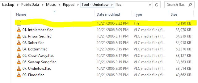

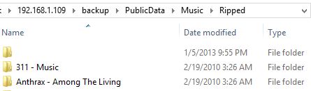

Looking further into the directories, I have found what appears to be corrupted files/directories:
Example from my ripped CD collection:
index.php
index.php
I'm not sure how this happened other than I had rebuilt a failed drive out of my 6 drive zfs and everything seemed to have worked fine.
