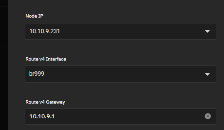

hey there,
looks like Kubernetes and a dedicated network interface is not an easy thing.

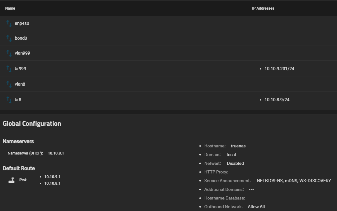

This is my lab decice. To keep things simialr between producitve and lab, it as single NIC bond
I want chart apps are only available within a single VLAN (VLAN999) in my case.
br8 is gets IP by DHCP as it shall be my GUI access (things are set by Router, less to mess up with).
looks like Kubernetes Node IP can only be a static IP, so I set

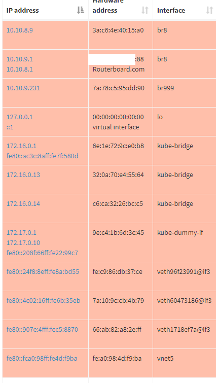

but I can reach Pi Hole on
  1. http://10.10.8.9:20720/
  2. http://10.10.9.231:20720/
Moreover, pi-hole sees only interface on TN plus router Gateway, not the VMs on TN or other clients in same VLAN
