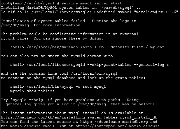

Thank you but this bug, can you go through the famp plugin? I have this error suddenly in the image. And the command cd / var / db / mysql && rm -rf *. ?? * after the && ca bug it doesn't recognize at all.

You probably need to reinstall the client package for MariaDB, too ...

it's good my server I was able to mount it super but not through Famp it beug, I created a jail and it all works. On the other hand I use Joomla, with wampserver that's no problem. How to use the source directory / usr / local / www / apache24 / data / to put several folder (site) different from joomla? I would have used the mount point well but I must be missing something because it is not working. and I don't have the source directory / usr / local / www / apache24 / data / something to do.
