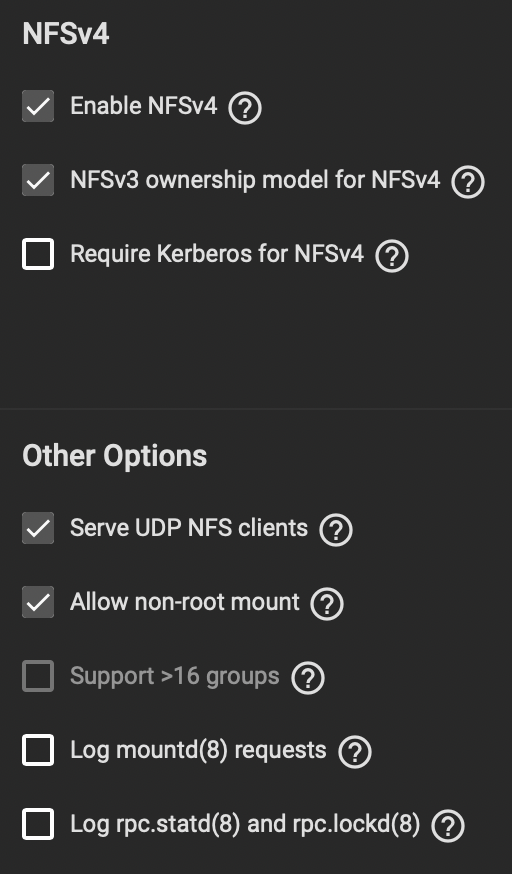

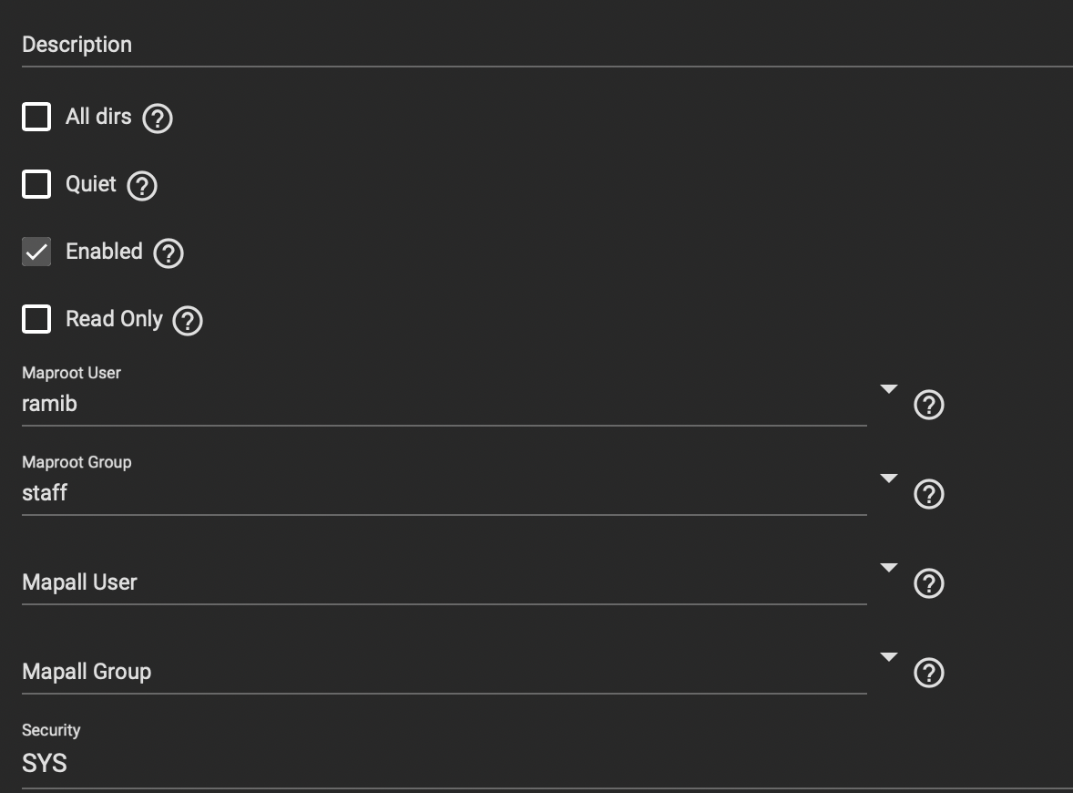

ramib
Dec 31, 2019
41
In NFS service settings, Enable NFSv4 is set. Two NFS shares are created for two clients, respectively.
Can clients mount these shares with NFS v3?
Can client1 mount its NFS share with type=nfs4 vers=4.1, while client2 mount its NFS share type=nfs vers=3?
you should be able to mount both v3 and v4 using the vers= option.
works from linux and Mac
please see the attached images , maybe it helps for the settings.
I had this issue once but don't remember how I fixed it, Sorry
