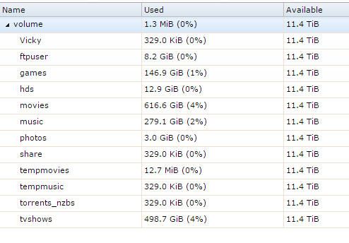

Nick Howard
May 20, 2014
129
Many thanks guys that's worked, I can now turn CIFS service back on. One last question if I can and without me looking through the guide. Is it possible for me to create this "share" dataset and then move all my other datasets under it? I'm guessing not but it's worth asking. : )
