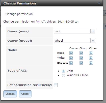

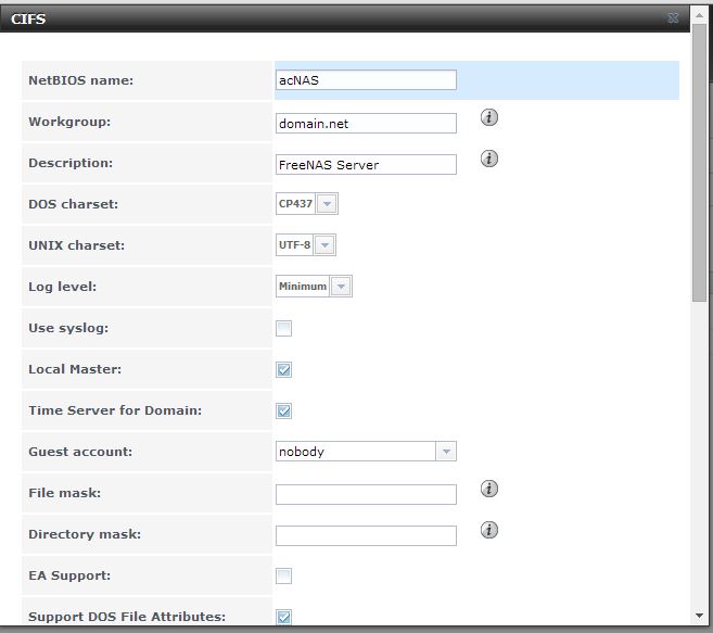

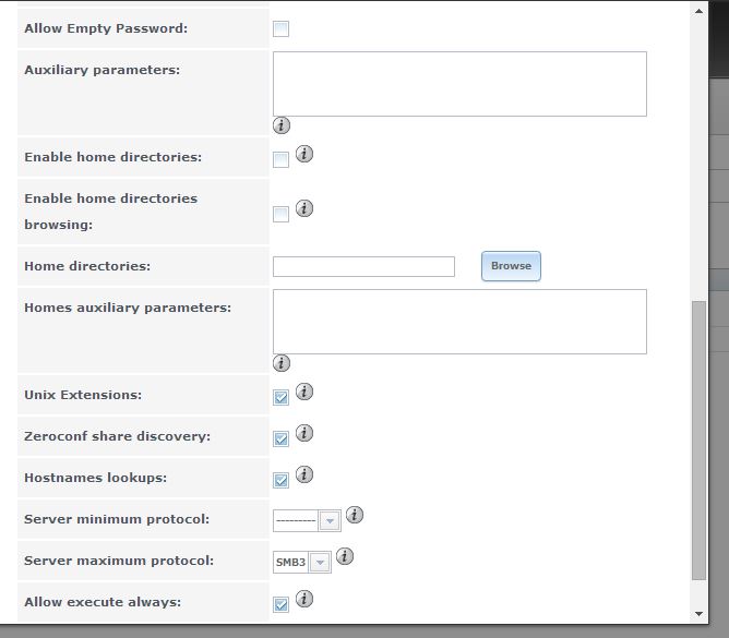

So, I'm trying to setup a FREENAS device to be used as an archive location for our backup software. To do so, I had to configure a new windows share for the location of the backup vault. Everything was working fine until the HDD was starting to get full.

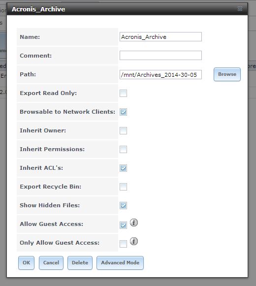

I decided it was time to change the hard drive to a new one, but upon rebooting the NAS with the new HDD installed. Somehow I've lost the cifs connectivity that I had only an hour ago. Changed the existing CIFS share path to the new HDD and when that didn't work, I deleted the share name and recreated it to point to the new HDD. But still no luck.
I've checked the permissions, and opened everything up as best I could (777) thinking that could be the problem. But to no avail.
Right now, the only clients that should be accessing this share are Windows 7 workstations, and the Acronis Backup software (running Windows server 2012)

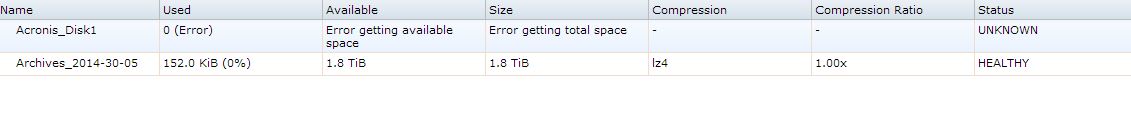

Also, in the screenshot with the HDD error, that belongs to the previous disk which I attempted to replace. So, I assume that it's displaying the error because I removed the drive from the NAS.
