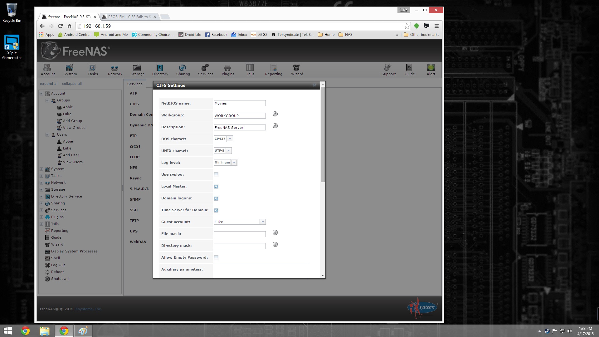

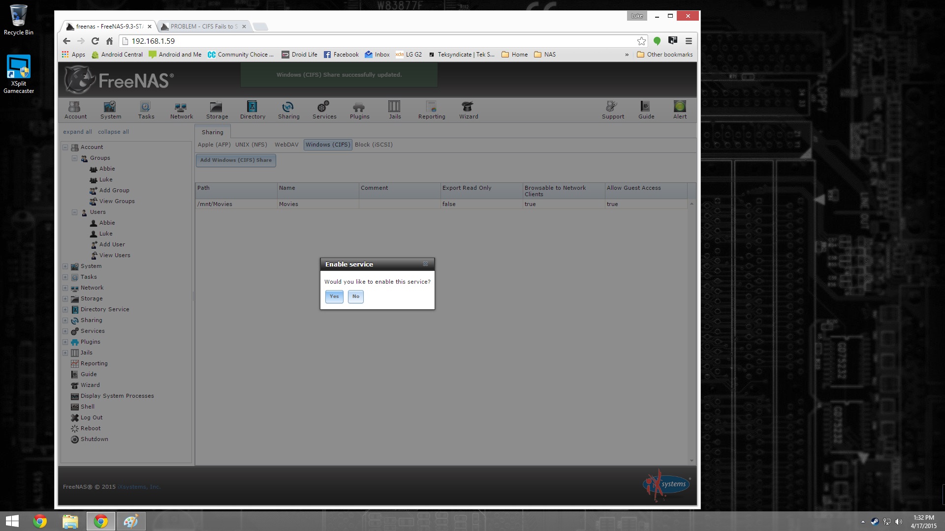

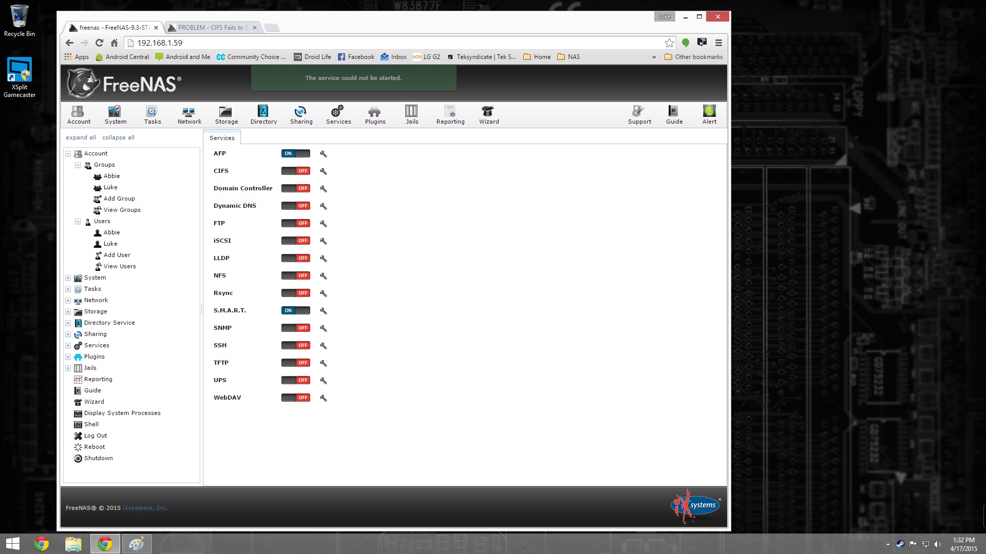

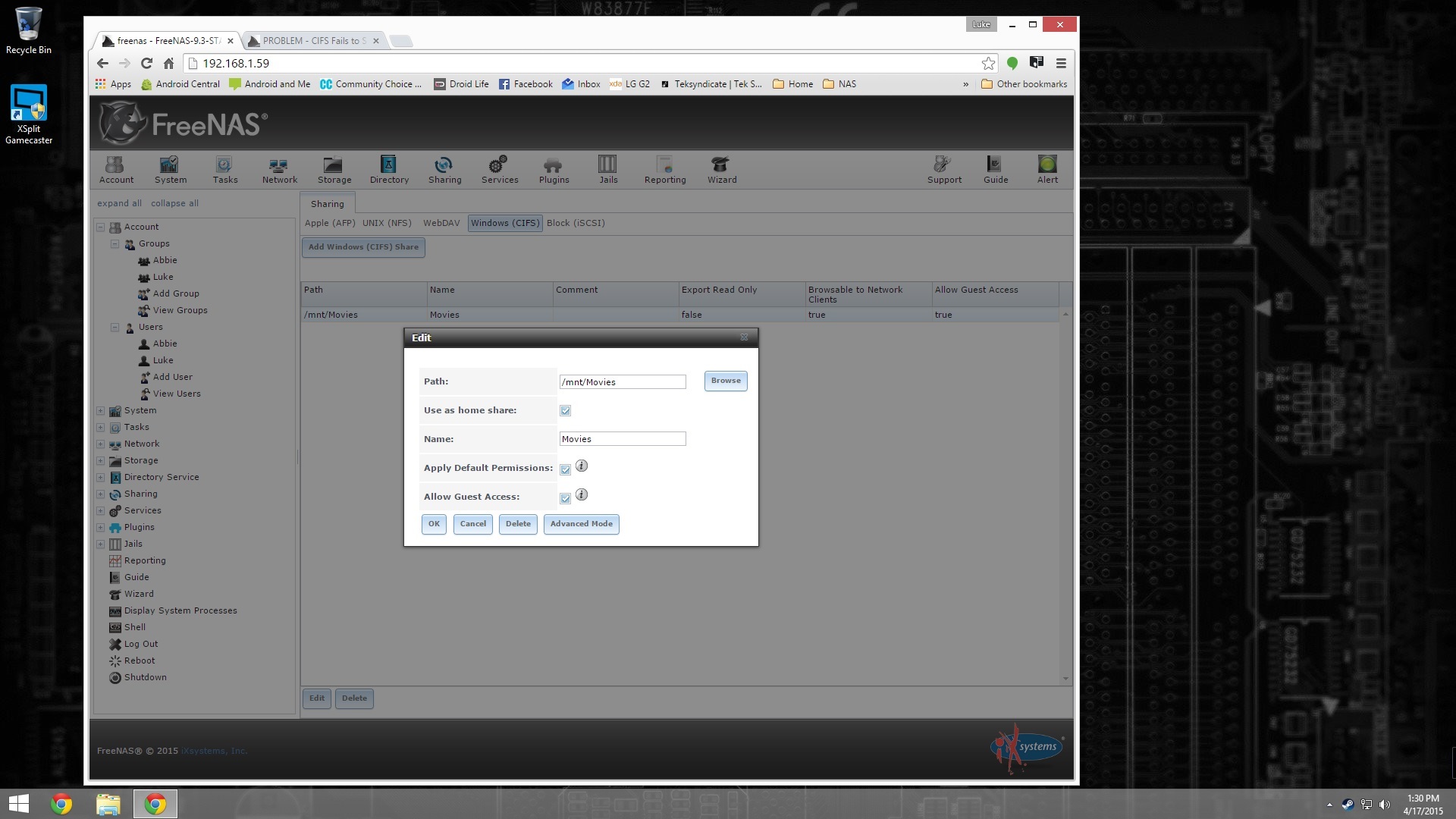

I am using the Web UI to start the service, so I only see the "service could not be started" box in green at the top. I will attach screen shots of the settings and error.

And I see the last line stats it's unable to set up the "Guest Account," which can be seen in the screenshots in the previous post as my user account. Once again thanks for helping out a newbie.

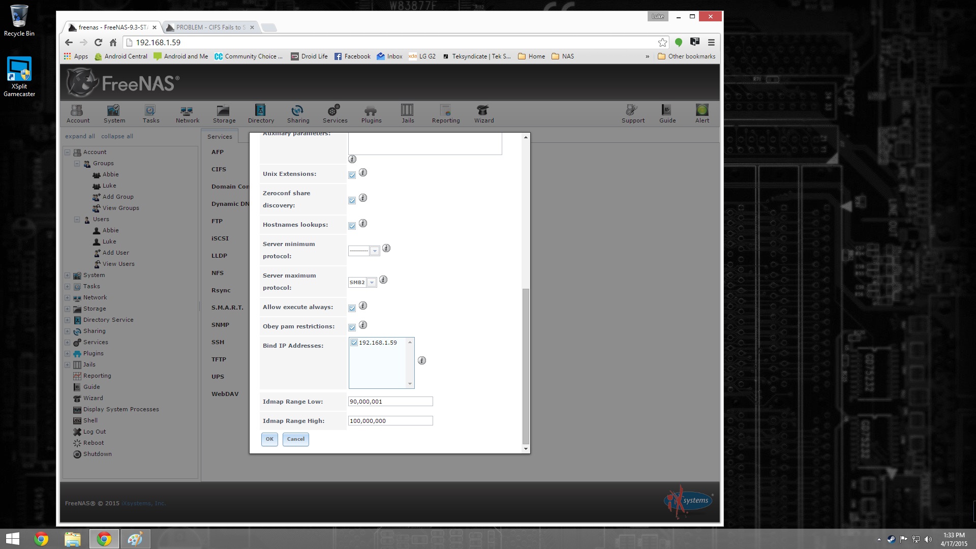

What's with the idmap range you have configured? Is that something you changed?

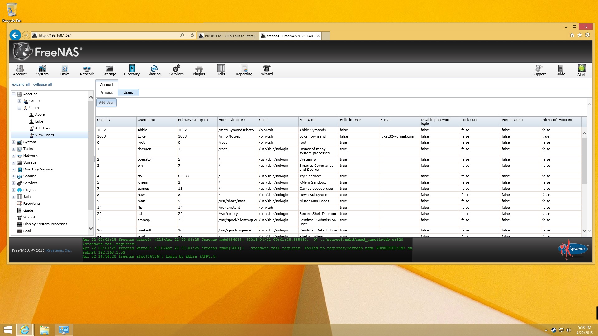

Did you create all the users under the user tab? Does Luke exist?
Luke exist. I'll attach a screenshot of the users list.
The idmap range I did not change. What should it be?

To my knowledge I haven't changed any of the permissions from default. I also tried activating the service with the "use default permissions" box checked and also unchecked with no luck.
I also have no idea what the difference is between home and normal shares. I did notice it gives you the option to choose between making the share a "home share" or not, I once again tried running the service with it checked and unchecked and no luck.
